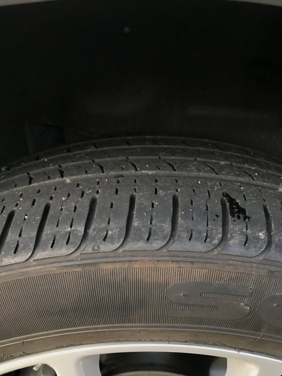

TX_CZ_Dad Posted November 30, 2015 Report Share Posted November 30, 2015 25k miles on our Journey SXT Blacktop and the right rear found half of a box cutter razor blade yesterday. The tires have been less than favorable in every performance category that I can think of, and are thus due for replacement. (Wouldn't give the Solus KH16 anything more than a "4" out of a possible 10.)Anyway, what I own is a 2014 Journey SXT Blacktop edition. The one that comes with the goofy P225/55R19 wheel size. Scouring the net over the last 24 hours has me looking at Continental TrueContact in correct sizing. (The Pirelli Cinturato seems to have less than favorable reviews in comparison.)None of my local "name brand" tire shops have what I need in stock, and thus I am ordering from TireRack and having the tires drop-shipped to NTB or my Dodge Dealer to have them installed. (Will having NTB install void any part of my Dodge bumper to bumper warranty?)Anyway, what I'm left wondering is; could I get to a slightly better tire if I went with a P235/55/R19 or P235/50R19? What is the largest footprint I can fit into my stock 19"-clad SXT? Will a P255 fit inside their respective tubs, and stay on the rim at 80mph?Any recommendations on tires? Again, know about the Continental TrueContact and Pirelli Cinturato, but only because of the last day's previous research. I'm still pretty naive when it comes to tire technology. Employees at my local (Now-Bridgestone-owned) Pep Boys were pushing me towards their only in-stock tire available; The Falken Ziex… Go figure. (Which I just don't know about.) A good buddy of mine was suggesting Michelin, but every review I have read in the last day that mentioned that name, basically said "X Tire is SO MUCH BETTER THAN MY MICHELINS/BRIDGESTONES!!!"I'm looking for something that will handle exceptionally well in wet weather conditions. Our roads here in Central Texas SUCK! A "smooth" ride is subjective, and I already have a factory stiff suspension; so buying tires for a "smooth" ride is irrelevant. This vehicle will more than likely never see snow, and handle little to no ice in it's lifetime. I would like to have something that keeps it's wits about it when a "spirited" foot hits a pedal and punches it through the floor. (OEM Kumho's just spin.) But I also do not need a full-on performance tire, as this is really just a shuttle for my little one, and will rarely if ever get "pushed." Someone help me. Too many options, and I don't have a clue which way to go. My head hurts, and I still need to get this vehicle back on the road in a couple of days. Lol. dhh3 1 Quote Link to comment Share on other sites More sharing options...

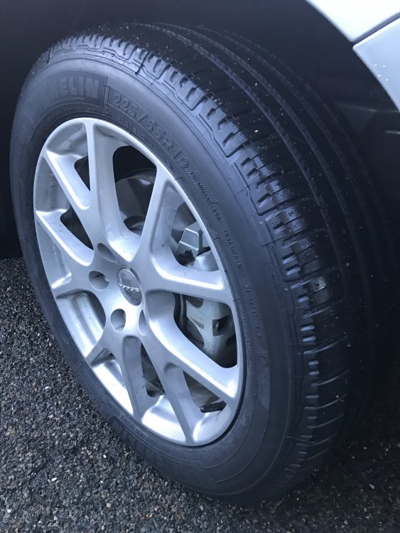

Jstmahoney Posted January 22, 2017 Report Share Posted January 22, 2017 (edited) Hit 23,000 miles and decided I couldn't stand the khumos any longer. Went with. Michelin Premier LTX. So far they are great! Worth the little extra money. Feel like I'm driving on a cloud. Ride seems a little stiffer. Lot less road noise too. And they have a little aggressive look to them. A lot better then stock. They were starting to feel like they were getting really soft. And the sidewalks looked to me like the tires had no air in them. Made the car ride terribly. Edited January 22, 2017 by Jstmahoney Quote Link to comment Share on other sites More sharing options...

Jstmahoney Posted March 16, 2017 Report Share Posted March 16, 2017 UPDATE!! I've had these tires for about 2 months now. I've been having a shimmy in the steering after you hit 65-70 and on up. This start d AFTER the tires were installed. Frustrated, cause I knew I'd have to take them back to figure out what was wrong with them. I checked out the rims and noticed these low lifes stuck the new weights over the adhesive foam. Took it in the next day and explained the issue as some weights had fallen off. They rebalanced all 4 tires and I was in my way. Two exits up th freeway I turned around and went back. Not any better. Went back and talks to the guy that supposedly balanced them. He told me that he had balanced all four tires, and that if I had an issue I need to get an alignment and check suspension. And that it was not likely I have a defective tire. Had the alignment done at the dealer and everything else checked out while performing oil change. The back rear tire was a little off. Picked it up still having the same issue . I took it back to the tire shop a few weeks later. I let them know that I had the alignment done and the cars ok, there's gotta be something wrong with the tires. They said they'd throughly check it again and let me know. They came back and told me that the rear driver side Tirehad a small nail in it and it was unrepairable and they ordered a new tire. They also said that the front tire was way off banance. As another weight had fallen off. Took it back days later once the replacement tire came in. I told them again about the issues that I had, The kid at the counter Kind of gave me a little attitude and a comment about how he balanced my tires before. And for the second time change the subject to how long of you had the car how many miles on the car and so on. I tell them it's 3 years old I bought it new it had 24,000 mi on it it's not the car the issue started AFTER the tires were installed. So again I pick up the journey and drive home. Same issue! For fear of losing my temper I go home to cool off. Slept on it and descided to call the manager. I explained to him my issues and that I would rather just get a refund and return the tires. He was very nice and let me know that was fine and he'd research what was going on. No I'm waiting for new tires to come in! I went with. Bridgestones instead. jkeaton 1 Quote Link to comment Share on other sites More sharing options...
