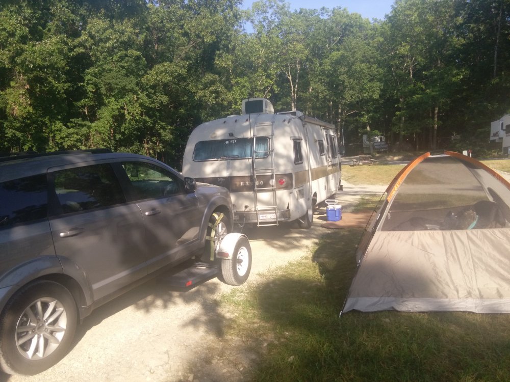

pzookey Posted August 7, 2016 Report Share Posted August 7, 2016 (edited) Interesting read. I specifically purchased our 2016 Journey in FWD so we could Dolly it behind out Motorhome. We told the Dodge Dealer this after the salesman tried to get us into a more dressed up model that was AWD. We repeatedly asked and were told it was no problem to dolly tow. We replaced a 2012 Kia Sorento with the Journey and it was also FWD. Only thing I have noticed is that the traction control and ABS have their trouble lights lit after dolly towing. A problem we only had with the Kia when the ignition was accidentally left on. The lights all go out within 5 minutes of driving so I am assuming the rear wheel sensors are always reading even when off and the difference between front and rear readings causing the code trip. Why the antilock/ ABS is active with the ignition off is beyond me but it is what it is. Edited August 7, 2016 by pzookey Add picture. dhh3 1 Quote Link to comment Share on other sites More sharing options...
Journeyman425 Posted August 7, 2016 Report Share Posted August 7, 2016 Love that vintage Travco! dhh3 1 Quote Link to comment Share on other sites More sharing options...
pzookey Posted August 7, 2016 Report Share Posted August 7, 2016 On 8/7/2016 at 8:38 PM, Journeyman425 said: Love that vintage Travco! Expand Thank You. We call her Nessie. Just found it in My manual on Page 84. FWD Journey is tow able on a Dolly behind a motor home front wheels up. I will no longer worry about that. Now just to figure out why the ABS/ traction control MILs light up after doing it. dhh3 1 Quote Link to comment Share on other sites More sharing options...
