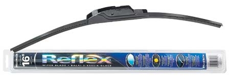

SeanTacular Posted January 14, 2016 Report Share Posted January 14, 2016 Do they make those "reflex" blades for the rear on the journey? The kind with no hinge and if you lift the blade off the glass it bends into almost a U shape? Those are the best blades by far. dhh3 1 Quote Link to comment Share on other sites More sharing options...

SeanTacular Posted January 15, 2016 Report Share Posted January 15, 2016 Maybe lol never heard of beam blades. Here a pic. They bend and follow any contour pretty good and if they don't make them for the back that really sucks lol dhh3 1 Quote Link to comment Share on other sites More sharing options...
