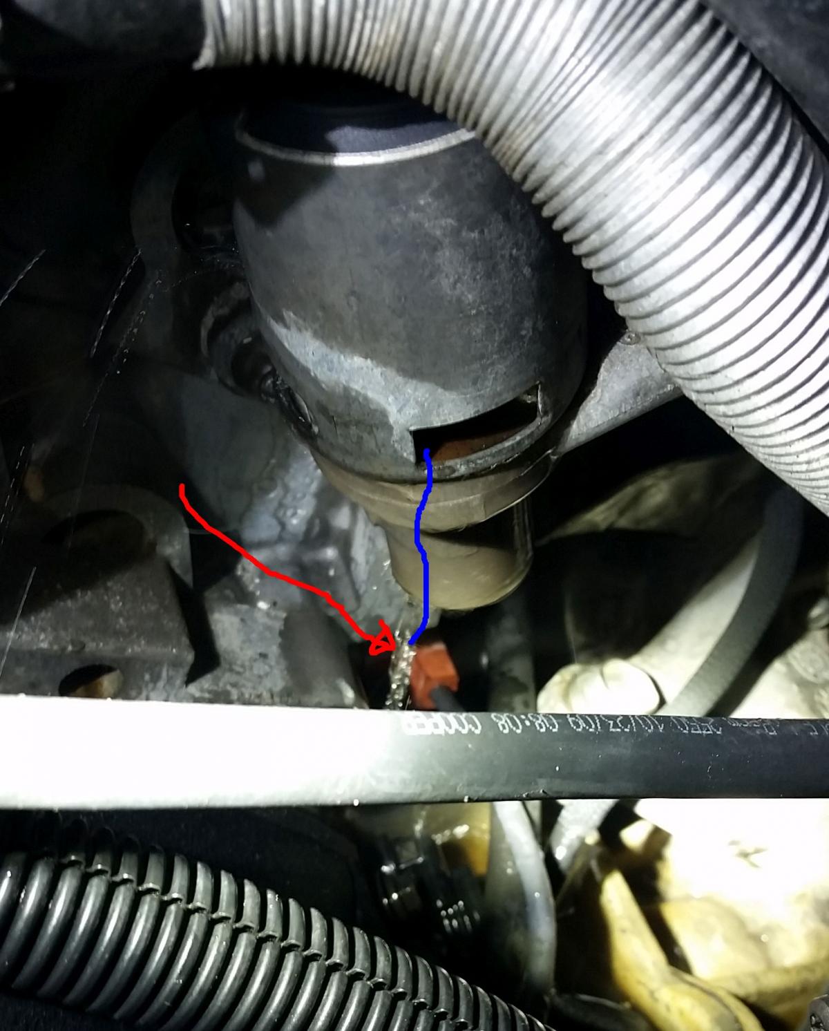

GFCH Posted January 16, 2016 Report Share Posted January 16, 2016 Hi al, I have a 2010 Journey R/T and it has sprung a leak. I have taken it to two shops and no one can figure it out. I have attached a photo but the fluid is leaking through the rectangular slots at the bottom of the piece shown by red arrow. I just got a call back from my Dodge parts guy and after 2 hours of searching (I showed him the piece and left him a photo) they determined it was the EGR valve. Is it the EGR valve and why would coolant be leaking from it? Is there something else close that could leak and it is just running through the EGR valve? The shop at my dealer is cloased today only parts open.. Cheers dhh3 1 Quote Link to comment Share on other sites More sharing options...

2late4u Posted January 17, 2016 Report Share Posted January 17, 2016 egr valves usually make your vehicle stall and or stutter never heard of one leaking coolant. dhh3 1 Quote Link to comment Share on other sites More sharing options...
BrianS Posted January 17, 2016 Report Share Posted January 17, 2016 (edited) Yes, my understanding of an "EGR valve" is that it opens a cavity between the intake and exhaust manifolds to facilitate Exhaust Gas Recirculation. I'm thinking if it has coolant coming from it, and it IS the EGR valve, you have bigger problems. And, according to what I have found, that IS the EGR valve, but again, no logical reason for it to have coolant coming from it. Edited January 17, 2016 by BrianS dhh3 1 Quote Link to comment Share on other sites More sharing options...
GFCH Posted January 17, 2016 Author Report Share Posted January 17, 2016 Hi guys, Yeah there is no logical reason that's why I was hoping maybe someone has seen this before. This is actually the second time it has happened to me. The first time I took it to the shop and they replaced the coolant temp sender. At the time I thought "gee that's a funny looking temperature sender". But it wasn't leaking anymore so I just went "OK, what do I know" That was about two years ago. I now know that even though the temp sensor is in the vicinity of the EGR they aren't connected so I'm left scratching my head. Oh well, back to the dealer in the morning. I'd post a video but its too big dhh3 1 Quote Link to comment Share on other sites More sharing options...

2late4u Posted January 17, 2016 Report Share Posted January 17, 2016 dam thats a good leak keep us posted. dhh3 1 Quote Link to comment Share on other sites More sharing options...
BrianS Posted January 18, 2016 Report Share Posted January 18, 2016 (edited) That is the 3.5L engine? I've got the Pentastar, so can't go and look for comparison purposes. Have you checked the rad hose above it for a split or pin hole? It looks awful close to the top of the valve, maybe it's got a hole worn in it? And, I agree with 2late4U, that's a nasty leak. Edited January 18, 2016 by BrianS dhh3 1 Quote Link to comment Share on other sites More sharing options...
GFCH Posted January 18, 2016 Author Report Share Posted January 18, 2016 Yup it aint pretty. But coolant temperature of engine is good never gets above "normal" A ding went off in my head, perhaps frost plug. Gotta squeeze in behind and take a look. What is weird is I had it "fixed" before as mentioned above. This time I had flushed the cooling system and perhaps the frost plug had enough stuff on it to plug the leak when flushed it cleaned it off. I'll let you all know dhh3 1 Quote Link to comment Share on other sites More sharing options...
dhh3 Posted January 18, 2016 Report Share Posted January 18, 2016 It looks like water. The coolant would have a tint of color to it. Quote Link to comment Share on other sites More sharing options...
GFCH Posted January 18, 2016 Author Report Share Posted January 18, 2016 Yes it is water. I had just flushed the system and was rinsing with water. That and as everything was being pumped out aI replaced with more water. Wasn't going to throw Coolant down the drain for a number of reasons Well apparently my epiphany was correct. It was a frost plug located just behind the EGR. Hole was such that it sprayed directly into the EGR giving the appearance it was the EGR. There ya have it . Bunch of money later and its fixed.. 2late4u, OhareFred, larryl and 1 other 4 Quote Link to comment Share on other sites More sharing options...
