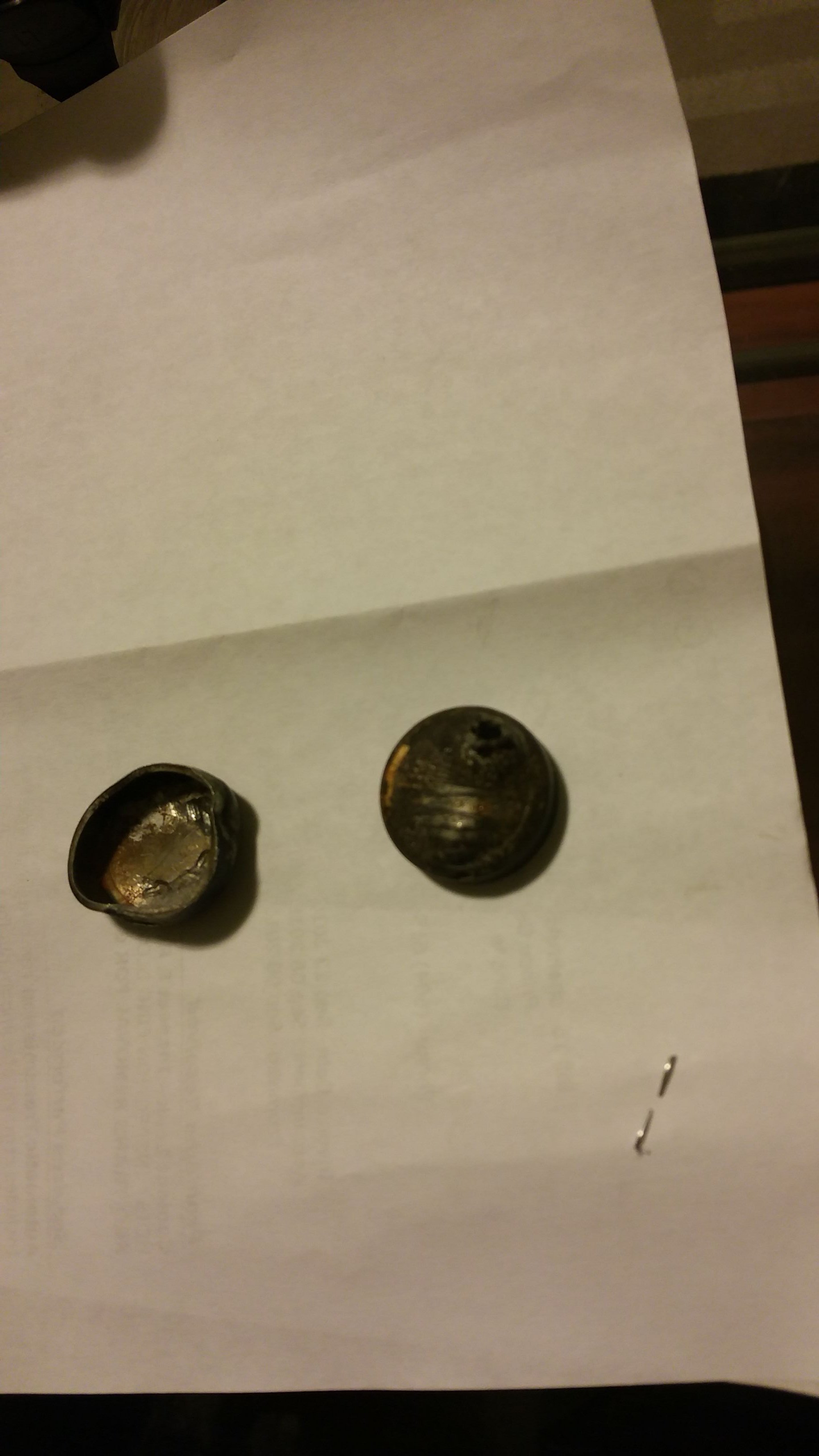

srk23 Posted September 13, 2016 Report Share Posted September 13, 2016 Just had frost plugs replaced on my 2010 journey 3.5L. Had same issue with leaking coolant then one day just started pouring out. Replaced all the frost plugs 2 of them completely rotted out one had a pin size hole other one had a hole size of a 3.5mm headphone jack. Quote Link to comment Share on other sites More sharing options...
