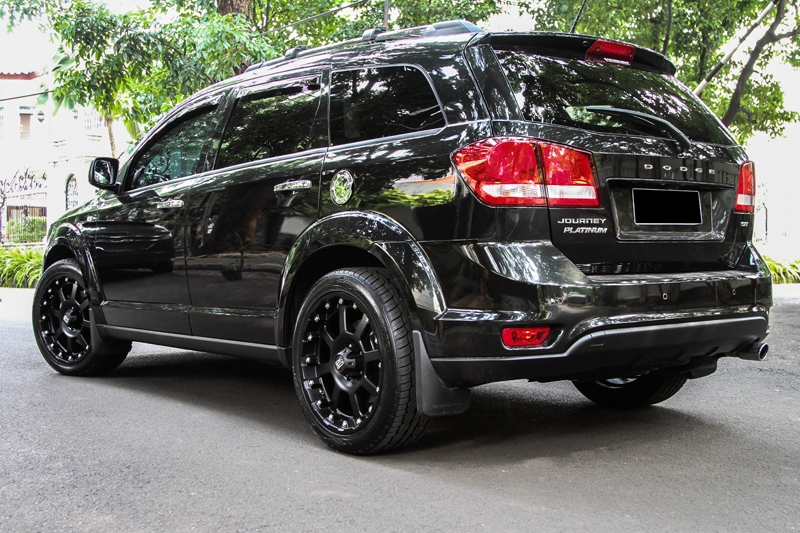

Steve_T Posted February 24, 2016 Report Share Posted February 24, 2016 I did some googling when I first got the Journey, looking at options, and as the bolt pattern is the same as my previous Jeep, there are a lot of low offset rims available My favorite site for comparing tire sizes and wheel offsets, is; https://www.rimsntires.com/specspro.jsp Where you can compare factory wheel/tire specs, to others you are considering. Attached picture is not mine, but one I found via google. I was tempted to try my 1.5" spacers on my stock wheels, that I had kept from my Jeep, and with a quick look with a tape measure, the factory wheels would have sat pretty flush with the body/fender. SeanTacular and dhh3 2 Quote Link to comment Share on other sites More sharing options...
SeanTacular Posted February 25, 2016 Author Report Share Posted February 25, 2016 Damn I googled for hours and couldn't find a pic of a DJ with low offset rims. That looks really bad ass. The rims are only $600 and I'm gonna use my original rubber to keep costs low and this pic has me thinking it will work perfectly!! jkeaton and dhh3 2 Quote Link to comment Share on other sites More sharing options...

Steve_T Posted February 26, 2016 Report Share Posted February 26, 2016 Oh, and just found that black one I posted above, google for; dodge+journey+kmc It brings up a few nice examples of bigger wheels. The black one I posted has 20's, with a 40 offset, probably 9 inches wide. SeanTacular 1 Quote Link to comment Share on other sites More sharing options...
