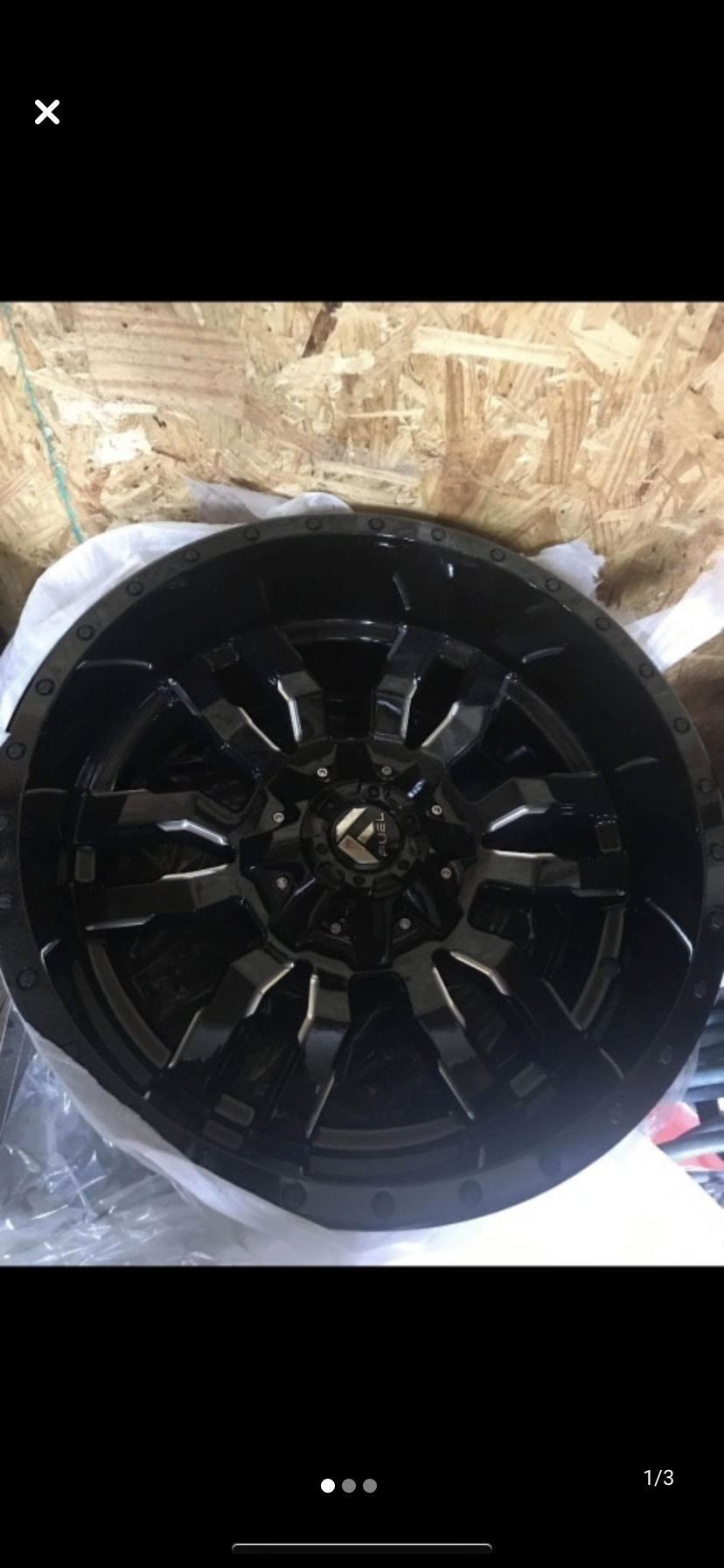

Clintw Posted February 19, 2020 Report Share Posted February 19, 2020 I want to go 20s and I found these 20x10 ijust wonna know should I go 255 40 20 or 245 45/20 Quote Link to comment Share on other sites More sharing options...
