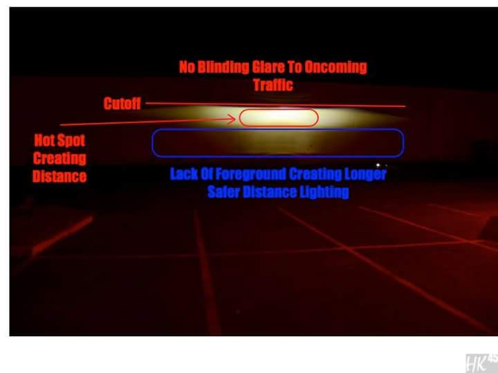

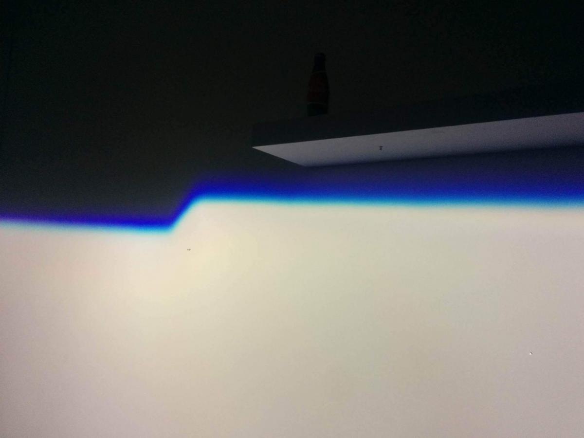

Cody Chornobey Powley Posted April 5, 2016 Report Share Posted April 5, 2016 Its not a war at all cause I already proved my point on proper lighting, if you have to aim your headlights down for on coming then maybe you should use the proper set up, sure some people may not flash you but your still aiming your headlights down hahah and that to me is dumb and some hid produce an enormous amount of glare and that when people start flashing, that's the lights scattering everywhere off the reflector cause it's not designed for it, they made hid to fit any.bulb hole easy money from guys like this group, pretty sure new laws are happening and banning plug and play hid I want to.prove a point that plug and.play hid and led are almost the same glare and not much distance compared to.my proper hid projectors...... Quote Link to comment Share on other sites More sharing options...
Camper Posted April 6, 2016 Report Share Posted April 6, 2016 Even your proper projectors can blind upcoming traffic. After retrofit with"proper hid projectors" entire head light need to be adjusted using proper tools. The reason for this,when you retrofit headlight, you can`t properly aim projectors. It human nature, it impossible to pinpoint for proper light with out proper tools and adjustment. Quote Link to comment Share on other sites More sharing options...
Cody Chornobey Powley Posted April 6, 2016 Report Share Posted April 6, 2016 Not really that hard.....park the car at 25 feet against a wall. Mark the cut off on the halogen lights. Do the retrofit park in the same spot and aim the projector to thw same spot. Been retrofitting for a few years, never once been flashed Quote Link to comment Share on other sites More sharing options...

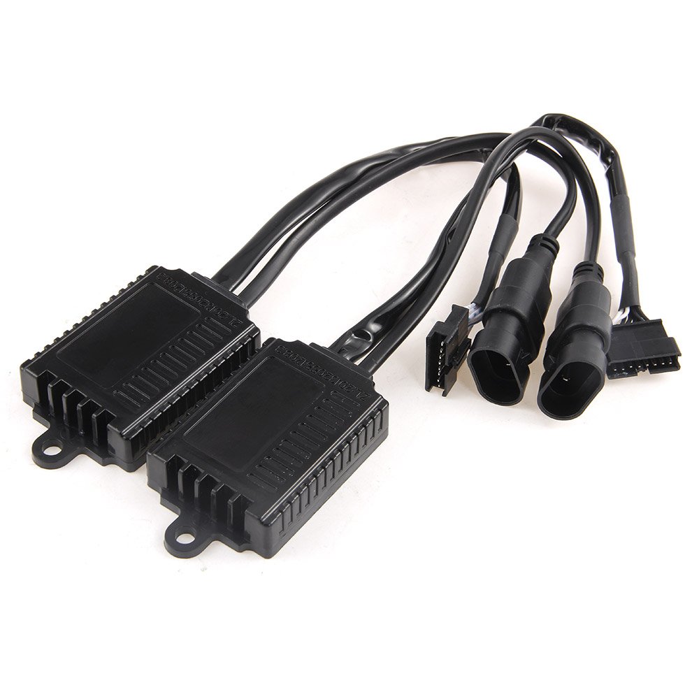

Camper Posted April 12, 2016 Report Share Posted April 12, 2016 if you check this: https://www.amazon.ca/gp/product/B016KNWUW6/ref=oh_aui_detailpage_o00_s00?ie=UTF8&psc=1#productDetails You will see the part, that i called "driver". So, if yours, do not have that part, that is great and it easy install. Then I will order same light as yours. here is the picture for that part: Quote Link to comment Share on other sites More sharing options...
Cody Chornobey Powley Posted April 12, 2016 Report Share Posted April 12, 2016 Don't think I need to say anything else, Quote Link to comment Share on other sites More sharing options...
Camper Posted April 12, 2016 Report Share Posted April 12, 2016 Exactly, I got your point, you dint need to say anything else. We all get your point, that the projectors you do install/mount in headlight is better (maybe/questionable).We all here have our choices to install or not to install LED bulbs or HID projectors. However I ask jkeaton, if he do have above parts with his LED light bulbs. jkeaton 1 Quote Link to comment Share on other sites More sharing options...
jkeaton Posted April 13, 2016 Report Share Posted April 13, 2016 if you check this: https://www.amazon.ca/gp/product/B016KNWUW6/ref=oh_aui_detailpage_o00_s00?ie=UTF8&psc=1#productDetails You will see the part, that i called "driver". So, if yours, do not have that part, that is great and it easy install. Then I will order same light as yours. here is the picture for that part: Interesting. Maybe because those are higher power than the ones I got. Regardless, the ones I got are plenty bright for half the cost. Quote Link to comment Share on other sites More sharing options...
Camper Posted April 13, 2016 Report Share Posted April 13, 2016 So, your LED lights, do not have that part and just plug and play? Correct? It 40W LED bulb, and yours I think is 30W Quote Link to comment Share on other sites More sharing options...
