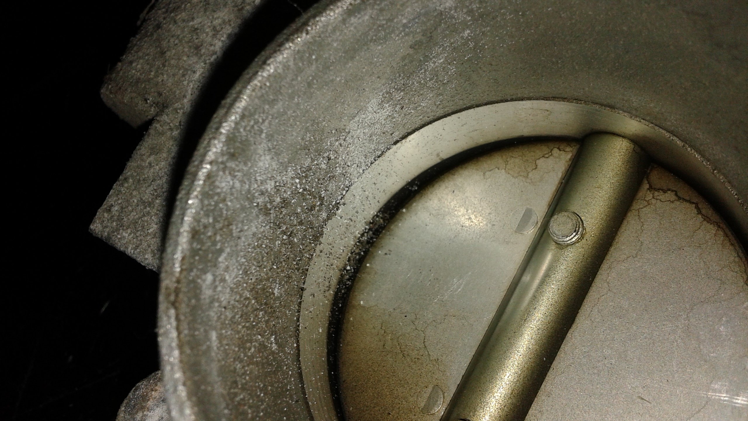

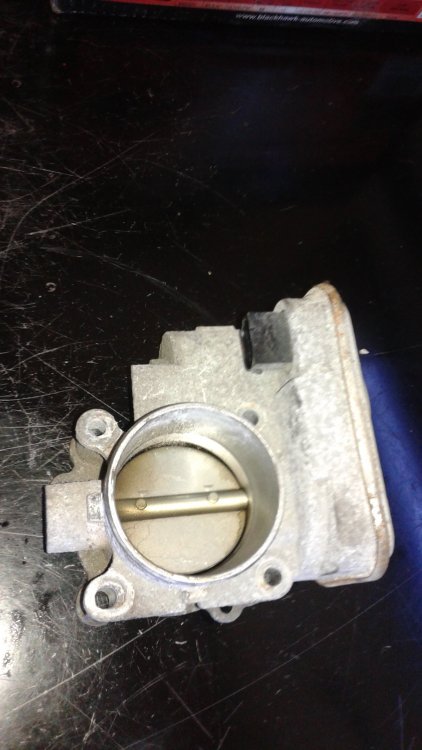

Hankster Posted July 8, 2017 Author Report Share Posted July 8, 2017 Update, the stumble and hesitation has been gone for over a year now, but has again started to do it. I found a couple of reasons first aluminum grit in the throttle body that seemed to be interfering with the throttle plate. The grit was from corrosion between the housing and the rubber air pipe. It was an easy job to pull out and clean.Second I also pulled the year old iridium spark plugs and put the specified nickel plugs obtained from my dealer. The driveability has improved and this car now runs smoother that I thought possible.If you are having hesitation, stumbles, bad shifting this definitely is worth a look. I had to go to the dealer for the proper spark plugs all the part stores in my area all recommended Iridium or platinum spark plugs for this engine even though they are not apparently compatible and only lasted 20,000kms. jkeaton 1 Quote Link to comment Share on other sites More sharing options...
