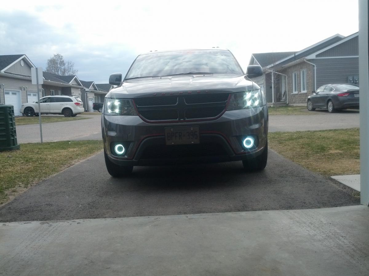

Cody Chornobey Powley Posted May 8, 2016 Report Share Posted May 8, 2016 These are my DRLs, the high beam bulb is still in place but just for looks, I have it unplugged and made up a fmale connector to the to Mt higbeam solenoid for my projectors. Fogs also are switchback for turn signals Quote Link to comment Share on other sites More sharing options...
