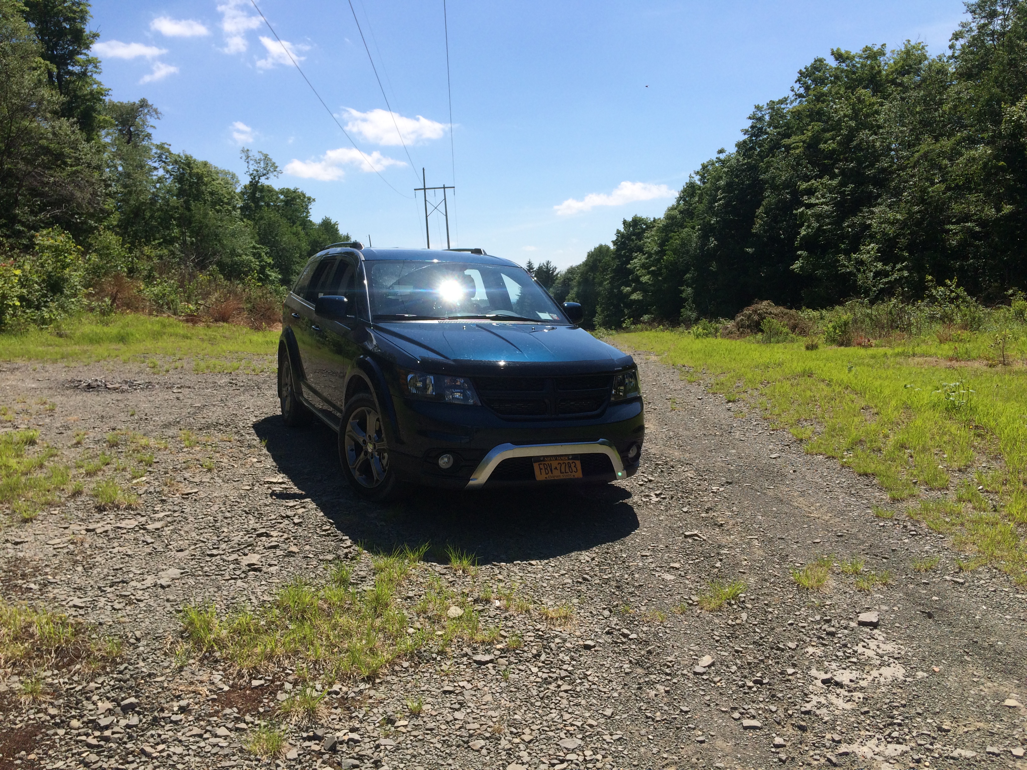

Offroadcrossroad Posted October 27, 2016 Report Share Posted October 27, 2016 me and my wife have taken our crossroad all over upstate NY and the Outer banks in the sand dunes, back roads, power line trails, with the factory tires we have had no problems 20K miles in so far. this year i am replacing the 19" rims with 17" and going with an all terrain BFgoodrich tire. the picture posted is a day after we took our crossroad home. in a power line trail in Upstate NY. jkeaton 1 Quote Link to comment Share on other sites More sharing options...
probak118 Posted October 29, 2016 Report Share Posted October 29, 2016 Just curious, why go from 19" tires to 17" ? I would have thought the larger diameter tire would be better for off road type trails having more clearance under the DJ ?. jkeaton 1 Quote Link to comment Share on other sites More sharing options...
bramfrank Posted October 29, 2016 Report Share Posted October 29, 2016 3 hours ago, probak118 said: Just curious, why go from 19" tires to 17" ? I would have thought the larger diameter tire would be better for off road type trails having more clearance under the DJ ?. Ground clearance is exactly the same for all sizes of wheel because the sidewalls of the tires are taller to compensate. But you have a lot more 'give' with a taller sidewall, which makes the smaller wheel more forgiving from the perspective of ride.. jkeaton 1 Quote Link to comment Share on other sites More sharing options...
BlindSquirrel Posted October 31, 2016 Report Share Posted October 31, 2016 indeed, the air space in your tyres is all part of the suspension system. Quote Link to comment Share on other sites More sharing options...
Offroadcrossroad Posted November 22, 2016 Report Share Posted November 22, 2016 i am going with a 17"rim mostly cause finding tires for the 19" rims is still hard. and i can Air Down a 17" more without risking it breaking off the bead. Quote Link to comment Share on other sites More sharing options...
