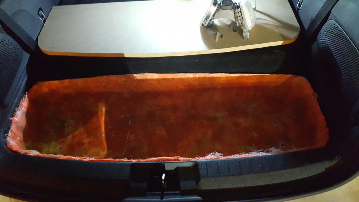

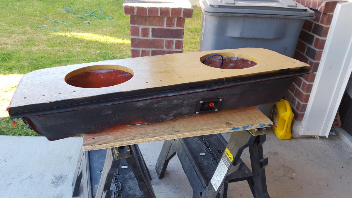

fazio Posted June 25, 2016 Report Share Posted June 25, 2016 I am in the process of installing a pair of subs and an amp. I made a custom fiberglass enclosure molded from the storage bin. I will try to post a thread when I am fully done. This is my first fiberglass enclosure. jkeaton, Greekbulldis, RaptorsFan and 4 others 6 1 Quote Link to comment Share on other sites More sharing options...
Marc Howell Posted June 25, 2016 Report Share Posted June 25, 2016 That looks like a good start there, are you lining the box to stiffen it up Eg milkshake, resin..... dhh3 and fazio 2 Quote Link to comment Share on other sites More sharing options...
dhh3 Posted June 25, 2016 Report Share Posted June 25, 2016 Where are you storing the jack? jkeaton 1 Quote Link to comment Share on other sites More sharing options...
fazio Posted June 25, 2016 Report Share Posted June 25, 2016 The jack is under the bin. That is why I have handles on the box, to be able to lift it up when I need to access the jack jkeaton and dhh3 2 Quote Link to comment Share on other sites More sharing options...

fazio Posted June 28, 2016 Report Share Posted June 28, 2016 That looks like a good start there, are you lining the box to stiffen it up Eg milkshake, resin..... After I molded the box using fleece and resin, I used fiberglass mat to reinforce it from the inside. jkeaton and dhh3 2 Quote Link to comment Share on other sites More sharing options...
Marc Howell Posted June 28, 2016 Report Share Posted June 28, 2016 After I molded the box using fleece and resin, I used fiberglass mat to reinforce it from the inside. You still need to add mass to the box as fibreglass is nowhere near as dense as your baffle and will flex and you'll lose the depth/volume in the sound. What size subs did you install. dhh3 and jkeaton 2 Quote Link to comment Share on other sites More sharing options...
fazio Posted June 29, 2016 Report Share Posted June 29, 2016 10". I added 3 layers of fiberglass mat. I can stand on top of the box and it doesn't budge. jkeaton and dhh3 2 Quote Link to comment Share on other sites More sharing options...
