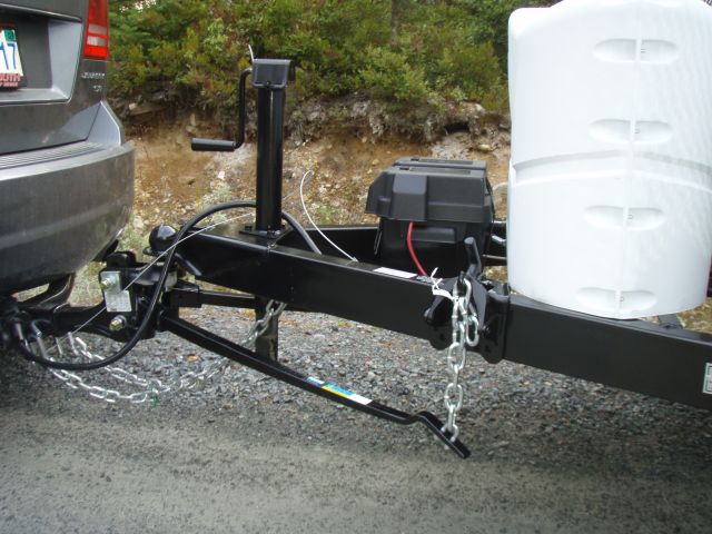

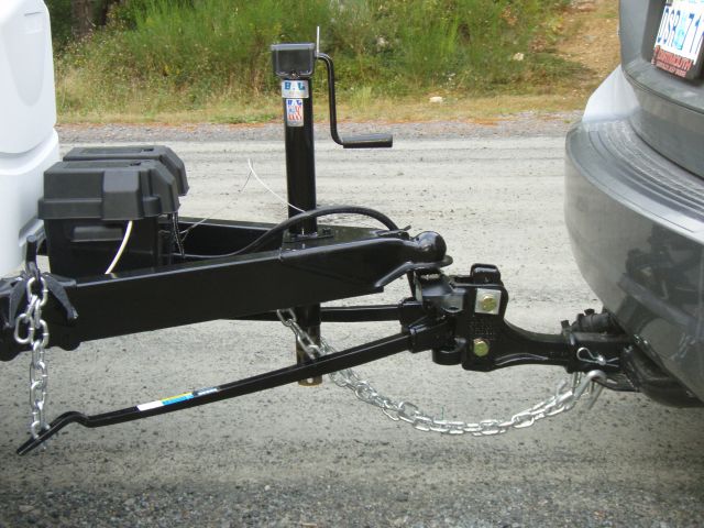

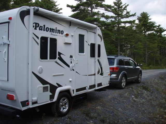

BUGS Posted September 21, 2009 Report Share Posted September 21, 2009 Not much chatter on the forum about large hauling so here it is. Pictures attached. The Journey hauls this pony very well although fuel consumption increassses as one would expect. (From 10 l/100 to 14.) Added 400 lbs to my Journey weight which means the beers have to go in the trailer. Class three hitch installed on the SXT Journey. Its a UHaul make with a 2 inch receiver. I have three trailers and two draw bars. Two bars are two inch ball and the third is a Load Leveller Hitch with a 2- 5/16" ball. I use the 4 pin for the small units (utility and hardtop camper) and the 7 pin harness (electric brakes and trickle charge on the trailer battery) for the Pony. Quote Link to comment Share on other sites More sharing options...
ckl Posted September 26, 2009 Report Share Posted September 26, 2009 Not much chatter on the forum about large hauling so here it is. Pictures attached. The Journey hauls this pony very well although fuel consumption increassses as one would expect. (From 10 l/100 to 14.) Added 400 lbs to my Journey weight which means the beers have to go in the trailer. Class three hitch installed on the SXT Journey. Its a UHaul make with a 2 inch receiver. I have three trailers and two draw bars. Two bars are two inch ball and the third is a Load Leveller Hitch with a 2- 5/16" ball. I use the 4 pin for the small units (utility and hardtop camper) and the 7 pin harness (electric brakes and trickle charge on the trailer battery) for the Pony. Thanks for the pics. I never knew the Journey could tow something as big as that. Aside from that, one question I have is that you get 10L/100km? I have never gotten anything below 12L/100km... but it could be that I have to drive up a 2km incline to get home. Quote Link to comment Share on other sites More sharing options...

BUGS Posted October 3, 2009 Author Report Share Posted October 3, 2009 To answer both of your questions. I drive conservatively with a lot of highway driving. That is why I get 10-11 l/ 100km. Now when I am in a 'mood' I will get 12. The Journey is an SXT with 3.5 ltr engine. While towing I generally leave it in auto on the flat runs on the highway but will drop it to 5th and use the Auto stick for hills (up and down). I was indeed surprised at the ability of this Journey when it came to moving this trailer along. This particular model is designed for this type of vehicle as it is generally 1000 lbs lighter than most trailers of like size. (18') Quote Link to comment Share on other sites More sharing options...

BUGS Posted December 17, 2009 Author Report Share Posted December 17, 2009 Tongue weight is not affected by the load leveller. The load leveller just keeps the trailer and tow vehicle level by 'lifting' the tongue which then transfers some of the combined weight away from the ball so that the brakes and steering work more efficiently. It also helps in minimizing vehicle bounce when you hit humps in the roadway. Your hitch will tell you on a tag somewhere and also by the class of hitch, how much tongue weight you can manage. In my case I manage about 400 lbs TW. (which is about 10 % +/- of total tow weight.) Be mindful though that the Mopar hitch by way of its design (angled) may not support a tongue weight of much more than 200 lbs. Which is why they limit them to 2000 lbs. tow weight. Tongue weight should be 10 % of the trailer weight for a trailer to tow properly. It is not advisable to shift too much weight to the rear of the trailer to ease the TW. This will cause swaying while towing and may lift your tow vehicles rear end and limit its braking potential. This is also dependant on the tongue length and the distance to the trailer axle from the tongue. Longer is better for towing ease. Quote Link to comment Share on other sites More sharing options...

BUGS Posted December 22, 2009 Author Report Share Posted December 22, 2009 Sorry, misunderstood. I am not certain on the weight required. I guess it is one of those things where you try and see if it will tow well without the leveller. The levellers are designed to make the tow more comfortable and are not necessarily required in all instances. Remember there is an upper limit on the tongue weight tho. Seems like 350 400 lbs might be the max for these vehicles. Quote Link to comment Share on other sites More sharing options...
