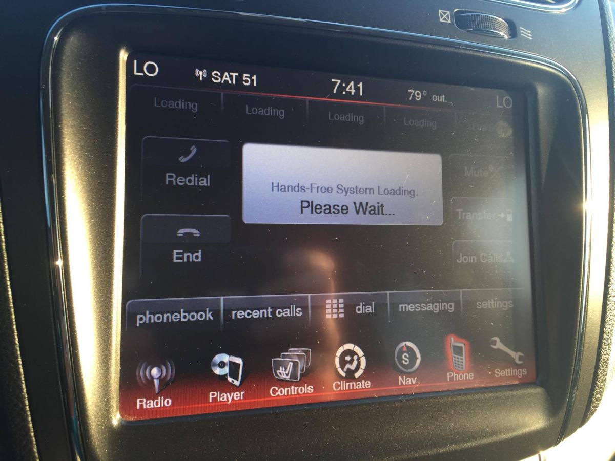

Blackout Posted June 18, 2016 Report Share Posted June 18, 2016 Hey Guys, Good Evening My Bluetooth has been working perfectly fine until tonight when I start the ride my bluetooth doesnt sync I go check and I select bluetooth and all I get is Uconnect handsfree system loading and it wont go away turn off ride wait 10min try again same thing Does this mean the bluetooth module is dead?Because the best part is my phone sees Uconnect in the list I tap it select the pin 0000 and hit pair and it goes to connect failure I have an iPhone but I cant even pair any other phone thats the best part even an android Any suggestions before I drive to the dealer? Radio has been replaced 2 times already I have a feeling were on the 3rd one Thanks Quote Link to comment Share on other sites More sharing options...
aukfan33 Posted June 18, 2016 Report Share Posted June 18, 2016 Disconnect he battery for 30 minutes. jkeaton and dhh3 2 Quote Link to comment Share on other sites More sharing options...
dhh3 Posted June 18, 2016 Report Share Posted June 18, 2016 x2 ^^ BTW, Uconnect officially only supports iOS 7.1. My 6s has 9.3.2 Phone works fine, but no incoming or outgoing text messages. jkeaton 1 Quote Link to comment Share on other sites More sharing options...
Blackout Posted June 18, 2016 Author Report Share Posted June 18, 2016 So disconnecting the - terminal will fix it for sure 100% ? Or is it a temporary fix ? dhh3 1 Quote Link to comment Share on other sites More sharing options...
bramfrank Posted June 18, 2016 Report Share Posted June 18, 2016 So disconnecting the - terminal will fix it for sure 100% ? Or is it a temporary fix ? It may not fix it at all. It is simply a suggestion that MIGHT help resolve your problem. And if it does, then it may, or may not be permanent. aukfan33, OhareFred, jkeaton and 1 other 4 Quote Link to comment Share on other sites More sharing options...
Blackout Posted June 18, 2016 Author Report Share Posted June 18, 2016 Appreciate it dhh3 1 Quote Link to comment Share on other sites More sharing options...
dhh3 Posted June 18, 2016 Report Share Posted June 18, 2016 (edited) It resets the vehicle's electronic system; like restarting your computer. Edited June 18, 2016 by dhh3 aukfan33 and jkeaton 2 Quote Link to comment Share on other sites More sharing options...
BlindSquirrel Posted June 20, 2016 Report Share Posted June 20, 2016 When mine did that, the bluetooth module was replaced under warranty. jkeaton and dhh3 2 Quote Link to comment Share on other sites More sharing options...
Blackout Posted June 21, 2016 Author Report Share Posted June 21, 2016 Yeah I tried resetting the battery didn't do anything I have an appointment booked next week dhh3 1 Quote Link to comment Share on other sites More sharing options...
Blackout Posted June 29, 2016 Author Report Share Posted June 29, 2016 They replaced the Bluetooth module all was working and today not a single phone can pair I'm so angry how do I lodge a complaint to chryslers i feel like I was sold a lemon of a vehicle Quote Link to comment Share on other sites More sharing options...

bramfrank Posted June 29, 2016 Report Share Posted June 29, 2016 Do you have uConnect with Navigation? If so, did you have the 'can't unlock maps' error? That they changed the radio means nothing if that's the case - there's a bug of some sort, but the radio doesn't have to be replaced, just reloaded - but it's just an FCA policy to replace the entire TGM. dhh3 1 Quote Link to comment Share on other sites More sharing options...
Blackout Posted June 29, 2016 Author Report Share Posted June 29, 2016 No issues with nav dhh3 1 Quote Link to comment Share on other sites More sharing options...
bramfrank Posted June 29, 2016 Report Share Posted June 29, 2016 So why did they change the radio twice? dhh3 1 Quote Link to comment Share on other sites More sharing options...
Blackout Posted June 29, 2016 Author Report Share Posted June 29, 2016 Nav issues I went to try the Bluetooth again and giving the message like before hands free loading please wait dhh3 1 Quote Link to comment Share on other sites More sharing options...
Blackout Posted June 29, 2016 Author Report Share Posted June 29, 2016 Anyone know how to soft reset the unit for UConnect dhh3 1 Quote Link to comment Share on other sites More sharing options...
jkeaton Posted June 29, 2016 Report Share Posted June 29, 2016 (edited) Blackout, on 29 Jun 2016 - 1:16 PM, said:Blackout, on 29 Jun 2016 - 1:16 PM, said:No issues with nav Blackout, on 29 Jun 2016 - 2:29 PM, said:Blackout, on 29 Jun 2016 - 2:29 PM, said: Nav issues I went to try the Bluetooth again and giving the message like before hands free loading please wait NO issues with nav but nav issues? Confusing. Edited June 29, 2016 by jkeaton dhh3 1 Quote Link to comment Share on other sites More sharing options...
Blackout Posted June 29, 2016 Author Report Share Posted June 29, 2016 I had issues with my nav a while back last year this year I have no nav issues My only issue is with the Bluetooth I have to bring it back in they need to see what the issue is at this point it's very frustrating dealing with things like this when you expect when you buy a new ride you have no worries but I guess not Quote Link to comment Share on other sites More sharing options...

Beauford Posted May 7, 2021 Report Share Posted May 7, 2021 I just bought a 2014 and I am getting the same issue, Uconnect is stuck loading. Obviously I have no warranty, so is the suggestion just to disconnect the battery for a while. The navigation seems to be fine. I'm assuming it would cost a fortune to have it fixed. Thanks, Quote Link to comment Share on other sites More sharing options...
