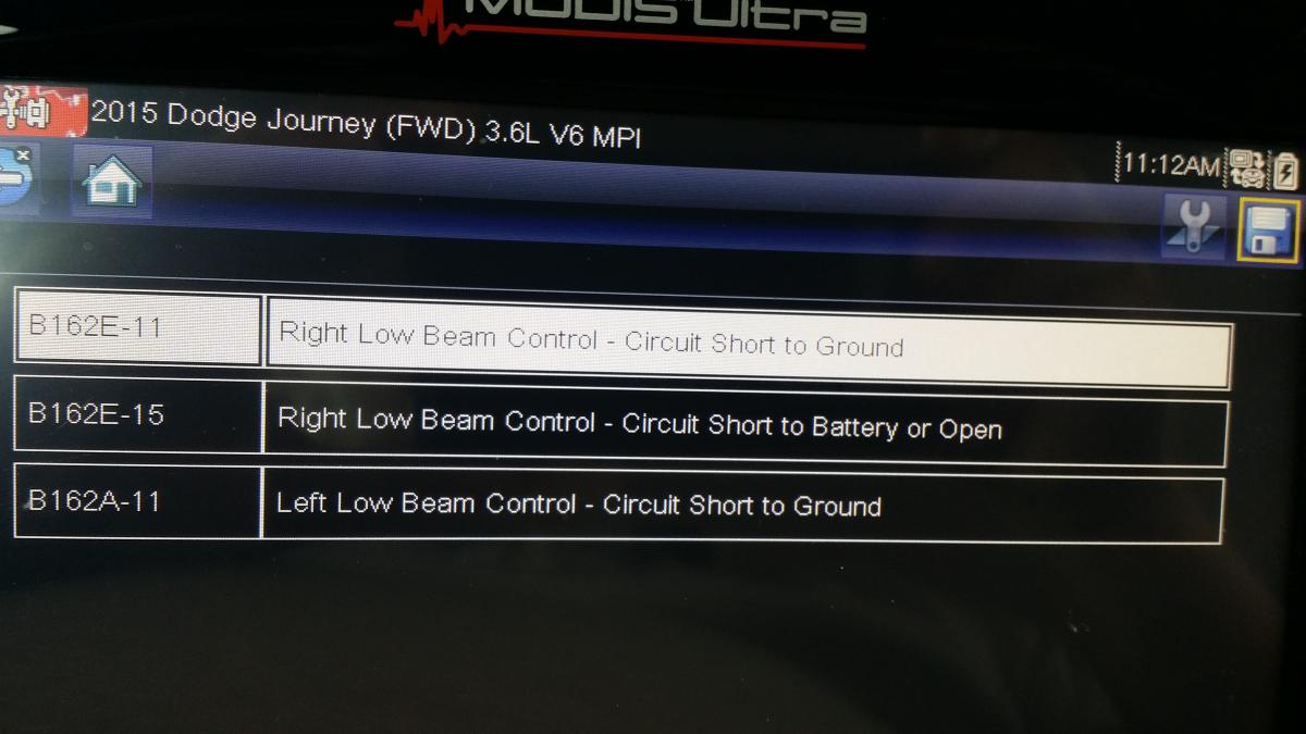

Camper Posted June 18, 2016 Report Share Posted June 18, 2016 Does any one received this error(please see attached) reported by body control module? I get this error, after replaced regular headlight light bulbs high and low beam with LED light bulb. To get that error, I went to my mechanic and used his professional ODB -II scanner. Quote Link to comment Share on other sites More sharing options...

Camper Posted June 22, 2016 Author Report Share Posted June 22, 2016 No matter what I try, I get those errors. Just replaced all headlights bulbs with LED, on my 2016 crossroad, hi beam and DRL working without any issue, as fog lights as well. However, low beam is different story. The lights, is turned on, so , when I switch gear to revers or drive position then right side low beam light turned off, when I put gear in the parking position and shout vehicle off light came back. I tried 4 different LED light bulb. However passenger light working without any issue. Quote Link to comment Share on other sites More sharing options...
Camper Posted June 22, 2016 Author Report Share Posted June 22, 2016 Old ,regular light bulbs, do not causing any error, only LED Quote Link to comment Share on other sites More sharing options...

Camper Posted September 24, 2016 Author Report Share Posted September 24, 2016 My LED do not contain ballast, it direct plug and play. I tried to switching the wires at the plug still same issue.No idea what to do. Will keep original bulbs for now. Quote Link to comment Share on other sites More sharing options...

Camper Posted January 17, 2017 Author Report Share Posted January 17, 2017 Issue was resolved today, by installing the harness with relay and one resistor. Now all LED light bulbs (same as jkeaton use) working as a charm, low beam, high beam, fog lights FlomotionJourney 1 Quote Link to comment Share on other sites More sharing options...
