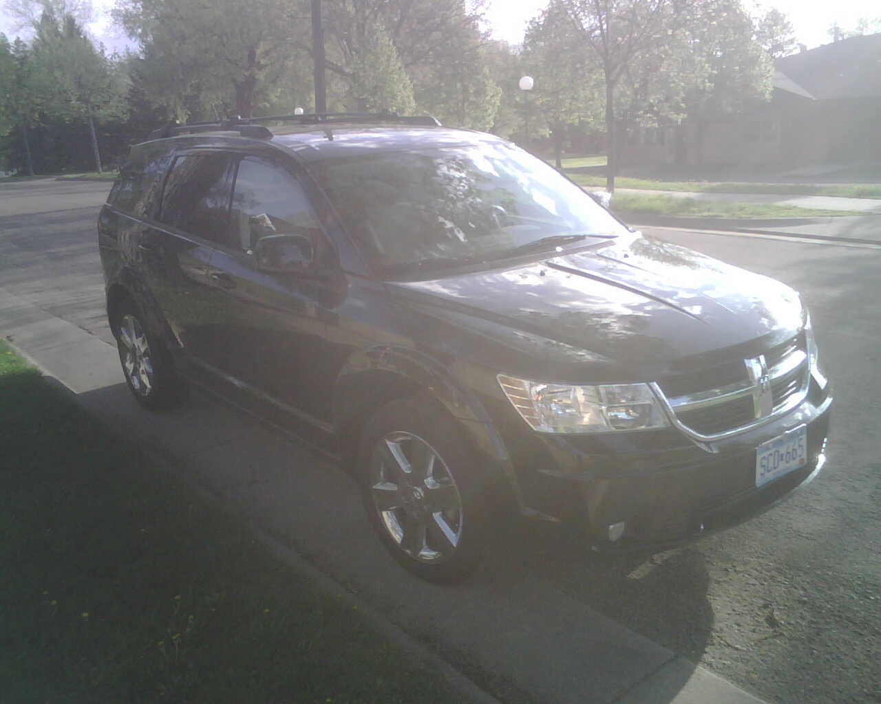

I just recently tried to purchase from wheelsnext.com, it was tough and a pain in the butt. I live in europe and would call then and call them to make sure they had what I wanted in stock, because I didn't want to wait 6-8 weeks just for them to get in the rims I wanted. I found my Helo 868's on tire rack, you can check them out, my journey is an '09 Inferno red.
Take your time on your wheel purchase.
