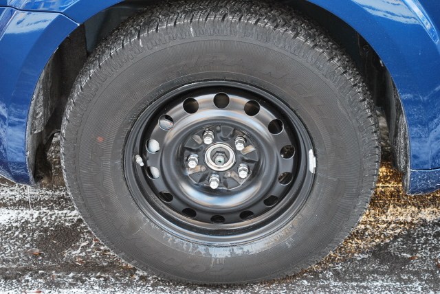

Canada_Jay Posted November 2, 2009 Report Share Posted November 2, 2009 I just picked up 17" steel rims from Apex in Oshawa. They cost $95/each Quote Link to comment Share on other sites More sharing options...

Clark Posted December 13, 2009 Report Share Posted December 13, 2009 From any Mopar dealer, the SE 16 steel wheels without hubcaps run approx $110. I found one dealer that wanted $98, but most others are ~$110. I have been looking for wheels also for a while and 4 days ago I ordered 4 black steels. I wish I would have seen the 2 people selling the 19s and 16s on here. Anyway, I was lucky enough to find 2 online in a junkyard at ~$60, but only 2 so I had him order me 2 new ones at $110 each. Just go see your local dealer and they can help. Only problem for me, is there is no local dealer here, or for a long, long way away. Quote Link to comment Share on other sites More sharing options...

09DWBJOUNEY Posted December 22, 2009 Report Share Posted December 22, 2009 I just purchased 4 steel wheel from Tire Rack for 57$ each + freight. Note the called to say the TPMS sensors would not work with the aftermarket wheel. The good news is the Jeep Wrangler TPMS did work. This was after I purchased 5 Jeep Wrangler Unlimited steel wheels, center caps and tires with sensors for 325$ off of Craigslist. The bad news is the rims interfered with the calipers both front and back. The good news is the TPMS and tires worked out great. Take it easy! DWB Quote Link to comment Share on other sites More sharing options...
Clark Posted December 23, 2009 Report Share Posted December 23, 2009 I just purchased 4 steel wheel from Tire Rack for 57$ each + freight. Let me know how they fit. I saw somewhere someone said they didn't seem to fit just right. Got a friend in Michigan who wanted to buy a set of my OE wheels, but it costs to much to ship them so he wants the tirerack ones if they fight right. Thanks, Clark Quote Link to comment Share on other sites More sharing options...
09DWBJOUNEY Posted December 23, 2009 Report Share Posted December 23, 2009 Let me know how they fit. I saw somewhere someone said they didn't seem to fit just right. Got a friend in Michigan who wanted to buy a set of my OE wheels, but it costs to much to ship them so he wants the tirerack ones if they fight right.Thanks, Clark They fit great! I will post some pics soon. No fitment issues at all. Note the Jeep Wrangler TPMS sensor that worked in the aftermarket rims where part number 56053036AA When Tirerack had the steel wheels back ordered they had a note saying they would not work with the factory TPMS sensors. Once they were in stock it said they would work or you could buy sensors from them. The day after I placed my ordered they called to say the factory TPMS sensors would not work but they had "modified" sensors that would work for 205$ for 4. I rolled the dice and got lucky. Happy Holidays! DWB Quote Link to comment Share on other sites More sharing options...
