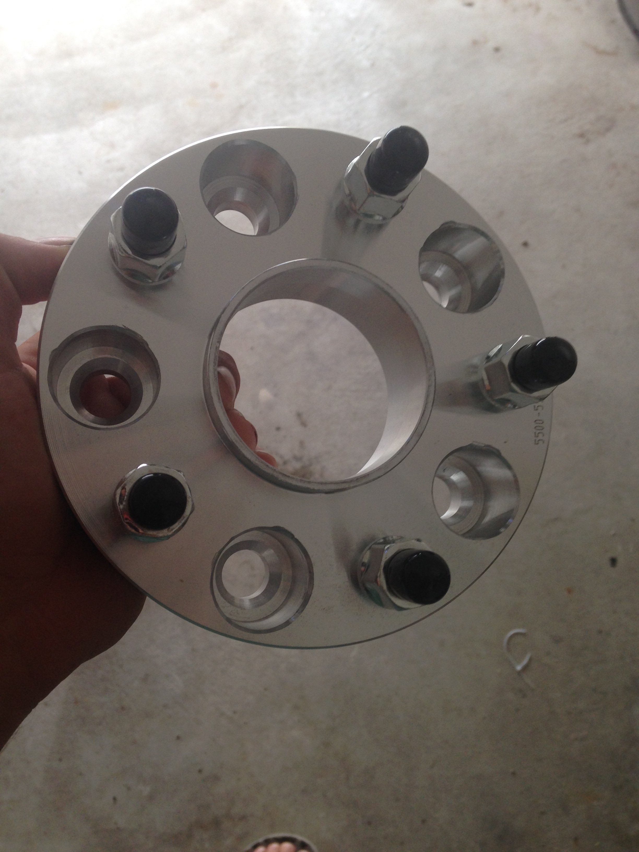

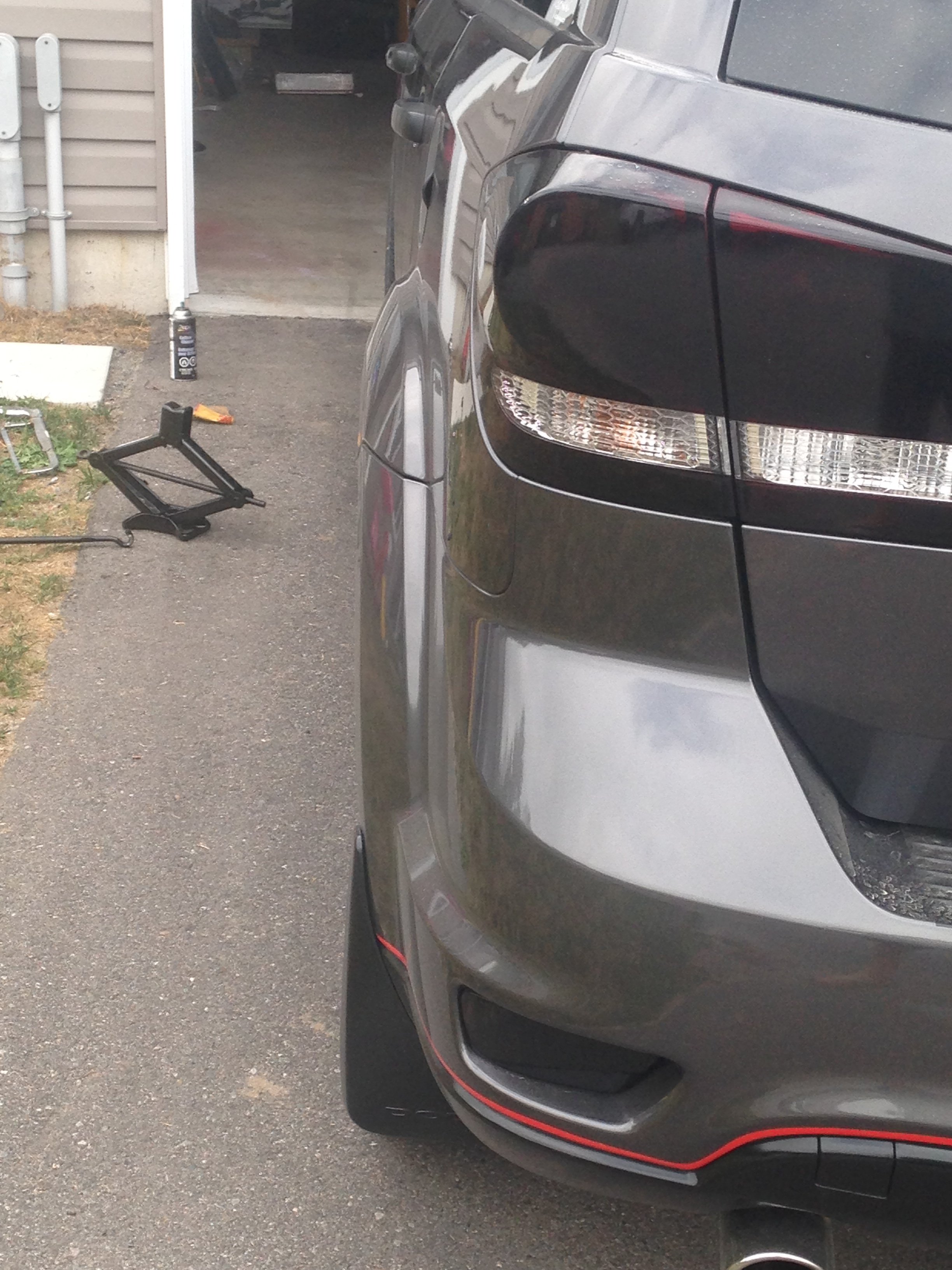

Cody Chornobey Powley Posted August 21, 2016 Report Share Posted August 21, 2016 I installed a set of 1.5inch wheel spacers not that long ago. Of course you would want the hub centric. These fit over the hub and lug bolts directly and it's a nice firm hold. No play . Only issue I had was where the battery is I had to push in the battery holder and heat up the fender liner and push it in so the tire didn't rub . You can see it's not a huge difference but handling has improved noticeably. Bought these spacers at pro wheel adapters. Ask for Chris . Only thing is my Oem lug nuts did not have the same thread as the new ones on the spacers. Used the Oem to hold the spacers and the new nuts supplied with the spacers for my wheels. dhh3 1 Quote Link to comment Share on other sites More sharing options...
99wjjeep Posted August 21, 2016 Report Share Posted August 21, 2016 nice!! How much did the spacers set you back? If you don't mind. dhh3 1 Quote Link to comment Share on other sites More sharing options...
Cody Chornobey Powley Posted August 24, 2016 Report Share Posted August 24, 2016 300 canadian dhh3 1 Quote Link to comment Share on other sites More sharing options...
