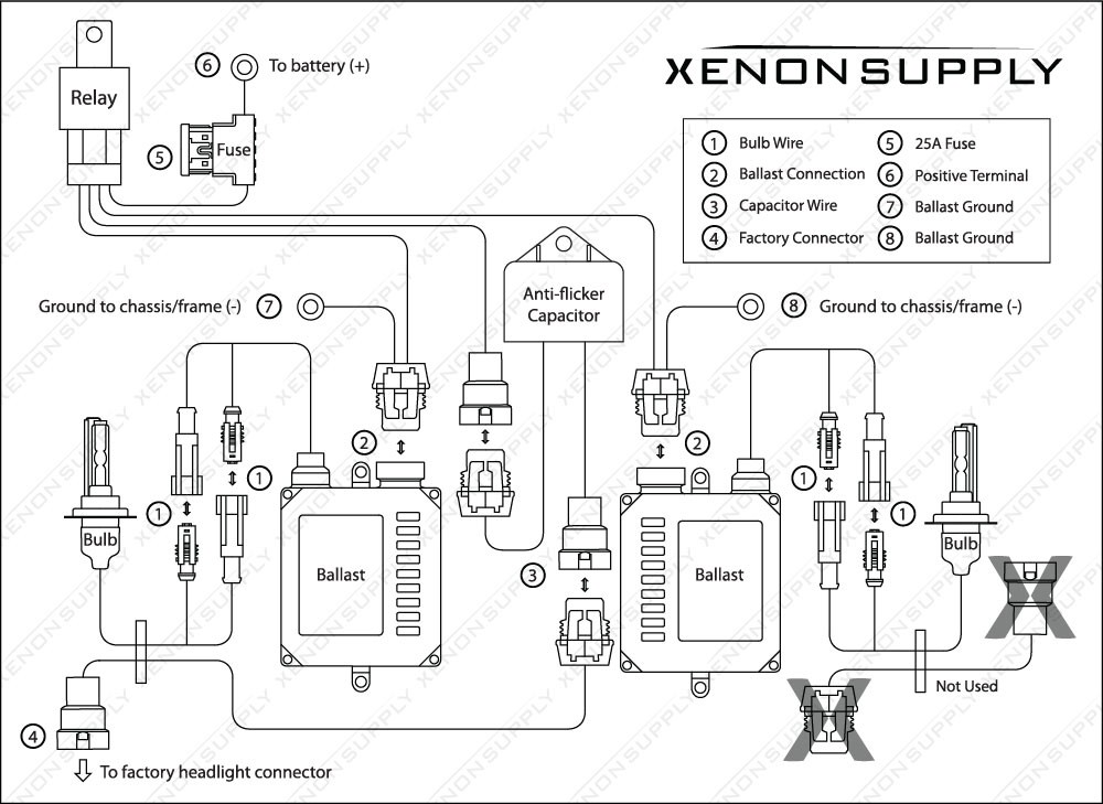

onecrazyfoo4u Posted December 30, 2014 Report Share Posted December 30, 2014 For my ddm setup, I had to plug the oem harness into the capacitor backwards...the + and - are opposite on my HID system. After that everything worked great. Quote Link to comment Share on other sites More sharing options...
SDot Drake Posted December 30, 2014 Report Share Posted December 30, 2014 That was the exact problem. I hooked straight to the battery. Then hooked one capacitor in reverse to the headlight switch. Viola. jkeaton 1 Quote Link to comment Share on other sites More sharing options...
SDot Drake Posted December 30, 2014 Report Share Posted December 30, 2014 This is the correct diagram. The flipping of the capacitor is the key. http://www.xenonsupply.com/media/stock/Accessory-Wiring-Harness-Layout-w-Capacitor.jpg jkeaton 1 Quote Link to comment Share on other sites More sharing options...

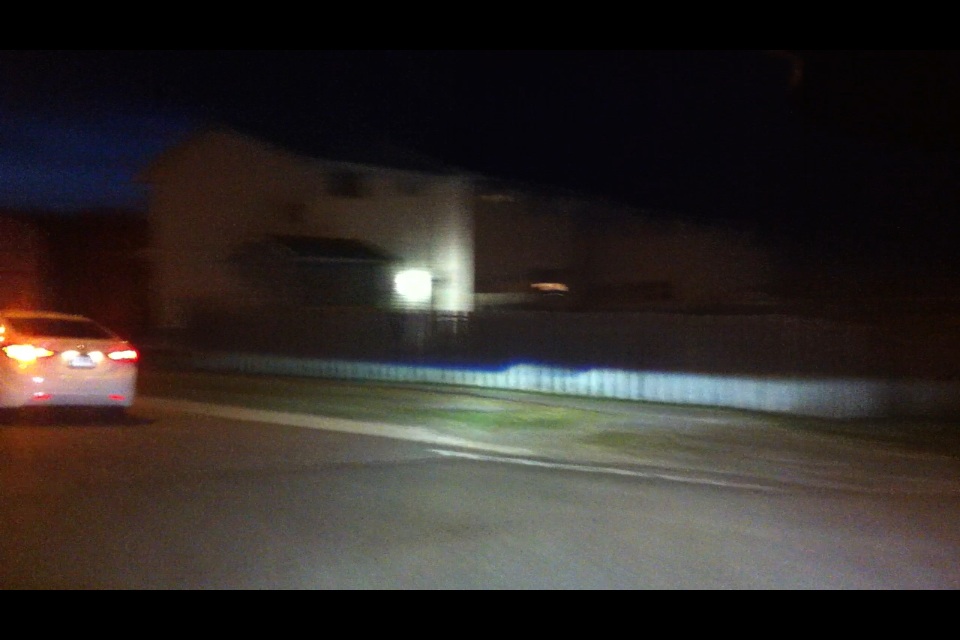

Rcorcoran Posted April 15, 2015 Report Share Posted April 15, 2015 Here are mine. 8K and LED fogs.How easy was ittaking off the fog lights to replace them? Quote Link to comment Share on other sites More sharing options...

Mikey Van De'Kamp Posted December 3, 2015 Report Share Posted December 3, 2015 Ok so I have a 2011 and I can not get the HID to work properly in this vehicle to save my life. I installed them the regular way then the lights would stay on until I went to drive then the passenger light would start going on and off and then it just cut off and stays off and it would do this every time then I installed with the relay harness and harness has power but the lights won't cut on, please help me understand this vehicle Quote Link to comment Share on other sites More sharing options...
Cody Chornobey Powley Posted December 3, 2015 Report Share Posted December 3, 2015 No help if its going in your regular housing did u buy projectors? Quote Link to comment Share on other sites More sharing options...
Mikey Van De'Kamp Posted December 3, 2015 Report Share Posted December 3, 2015 I retro fitted some projectors Quote Link to comment Share on other sites More sharing options...
Lobitz68 Posted December 3, 2015 Report Share Posted December 3, 2015 (edited) I am using a harness with a large capacitor inline to absorb the PWM signal that the vehicle gives. The pulse width modulation doesn't give a steady 12 volt signal to the relay which will cause some relays to open and close rapidly. Basically, the signal will pulse from a lower voltage signal to a higher voltage signal constantly. I also have a resistor wired in on the passenger side to avoid light out warnings. With the relay harness are you getting them to work at all? The harness I have is the Mopar specific harness from TheRetroFitSource.com and is built well. I purchases the resistor and a plug for the passenger side separately. There are some relays available that will operate on less than 12 volts too, which may also help. Edited December 3, 2015 by Lobitz68 Quote Link to comment Share on other sites More sharing options...
Mikey Van De'Kamp Posted December 3, 2015 Report Share Posted December 3, 2015 When the wiring harness is attached the lights don't power on at all but there is power when I check it with the voltage meter Quote Link to comment Share on other sites More sharing options...
Lobitz68 Posted December 4, 2015 Report Share Posted December 4, 2015 When the wiring harness is attached the lights don't power on at all but there is power when I check it with the voltage meter So they don't work whether the car is running or not? Some harnesses have the power and ground pins switched. Have you tried flipping the plug from the harness to the ballast 180 degrees? Can you hear the ballast powering on? jkeaton 1 Quote Link to comment Share on other sites More sharing options...
jkeaton Posted December 4, 2015 Report Share Posted December 4, 2015 Try flipping the light connector. Every one I have ever gotten I always have to plug them in "backwards". Quote Link to comment Share on other sites More sharing options...
