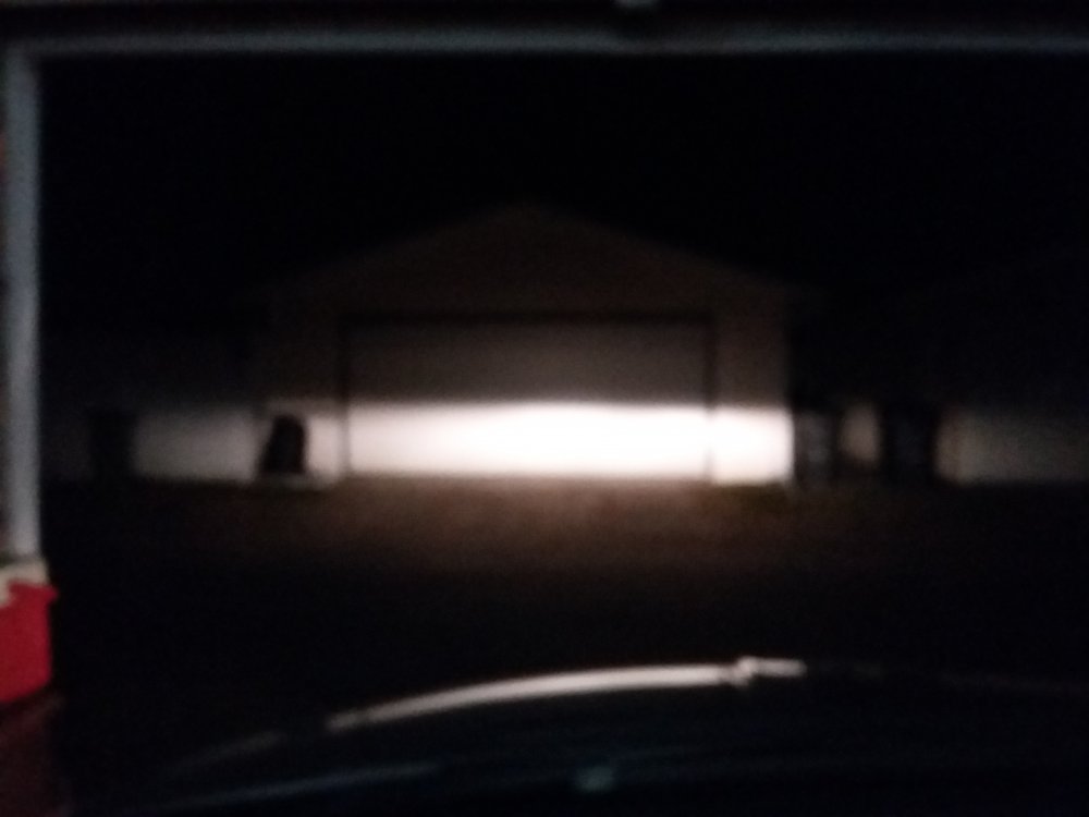

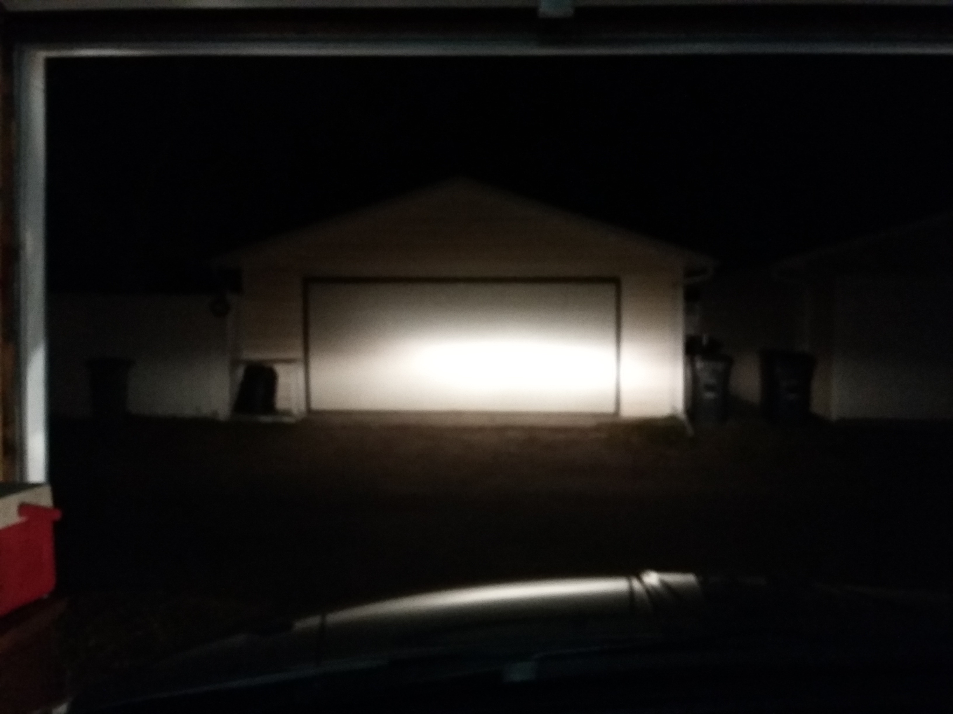

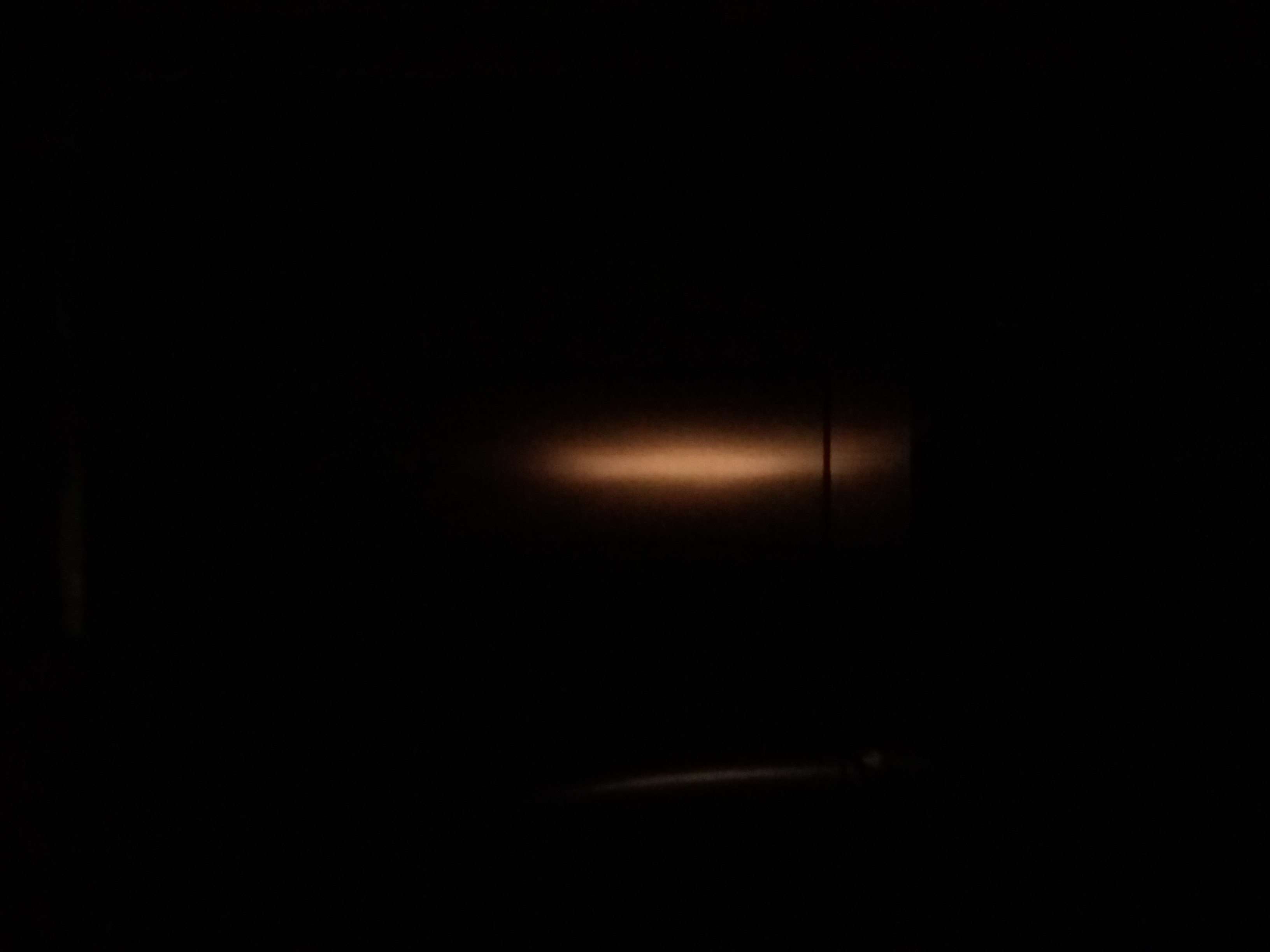

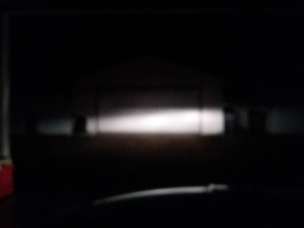

Exitus04 Posted September 23, 2016 Report Share Posted September 23, 2016 (edited) Here are some pictures from the difference in my headlamps before and after: Before: After: I think i understand now more of what they were trying to say about the reflective vs projector headlights... I didnt realize that the journeys dont have projector headlights.... Edited September 23, 2016 by Exitus04 Quote Link to comment Share on other sites More sharing options...

vozaday Posted October 8, 2016 Report Share Posted October 8, 2016 Some halogen projectors do stand up to it and have a decent cutoff. Not always perfect but 100 times better than HID's in a reflected housing. Another major factor is the quality of hids, low quality ones tend to build excess heat and can melt components, good quality ones are substantially cooler. Plus bulb alignment is a lot better with quality HID's. This I know you know as you do retrofits with morimoto stuff. It is amazing the difference say between DDM HID's and Morimito. That being said, wow the glare off of the images 2 posts up is insane. I haven't even seen that much glare out of any lights I have ever put in. Be really brutal for other drivers. jkeaton 1 Quote Link to comment Share on other sites More sharing options...
