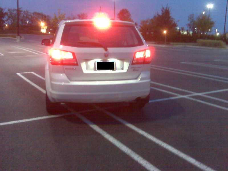

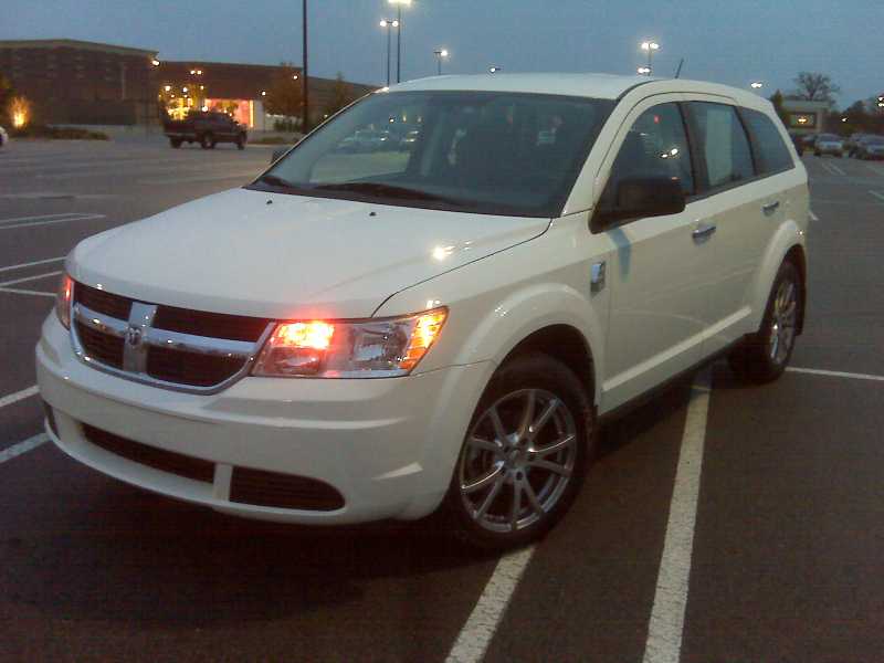

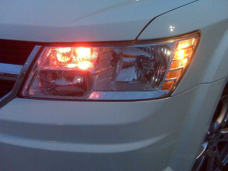

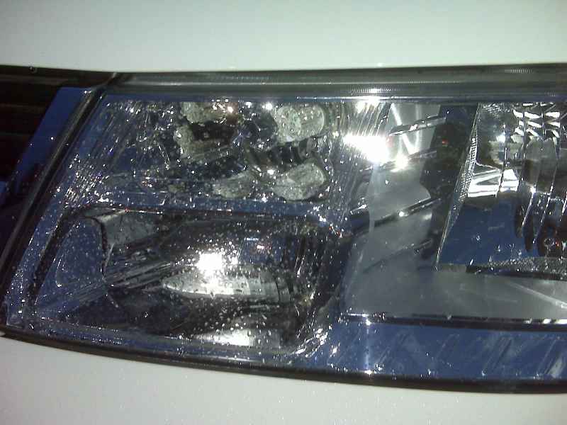

email4walker Posted October 15, 2009 Report Share Posted October 15, 2009 I switched all my lights to LEDs (and I do mean all, inside and out)! To see how to switch the inside lights to LEDs, see this posting: http://www.dodgejourneyforum.com/index.php?showtopic=297 If you want to switch all the outside lights to LEDs, there is a few things you should know: - I have the Journey SE, and there is not a bulb out warning signal or light. I even read the manual and it does not say anything about a bulb out warning signal or light on any of our trim levels (SE, SXT, or R/T). -Use a 3157 to replace the 3757. They are pretty much the same, but you will need to sand down the little bump on the side of the plug on the bulbs. It is really easy. Once you get your bulbs and try to plug them in, you will see what I’m talking about. It is easy. -Get as many LEDs on each bulb as you can. For example, each one of my brake lights has 39 LEDs. Get that many or higher on your brake lights. Anything less is not bright enough. -For the turn signals, buy amber color LEDs. Honestly in the front, the LED turn signal bulbs look sweet, but in the rear, you can’t tell if it is LED or not. I changed mine anyway so all of them are the same color amber (the stock bulb is a different color amber compared to the LED amber). -for the brake lights, buy red color LEDs. Bright white LEDs in the red lens will turn out to be a very washed out red. Not a good look at all (it will look worse than the stock bulbs!). -Don’t switch the front side markers to LEDs. Leaving those really makes your turn signal LEDs stand out and adds contrast. Trust me, it looks nice. These are the bulbs I used. What you use is up to you. Different LED bulb sets give off different shades of light. Example, my turn signal bulbs are bigger than my brake light bulbs, but they give off less light and the amber color is a real deep amber. It looks nice. You may want to buy two different types of each bulb and try them out. Just return or sell the ones you don't use. I did that for my reverse light bulbs. Turn signal LEDs: Stop light LEDs: The reverse LEDs look just like the stop light LEDs except the color they give off is bright white: Here are some pics (the bulbs/colors look better in real life): Quote Link to comment Share on other sites More sharing options...
Remline Posted October 16, 2009 Report Share Posted October 16, 2009 I switched all my lights to LEDs (and I do mean all, inside and out)! To see how to switch the inside lights to LEDs, see this posting: http://www.dodgejourneyforum.com/index.php?showtopic=297 If you want to switch all the outside lights to LEDs, there is a few things you should know: - I have the Journey SE, and there is not a bulb out warning signal or light. I even read the manual and it does not say anything about a bulb out warning signal or light on any of our trim levels (SE, SXT, or R/T). -Use a 3157 to replace the 3757. They are pretty much the same, but you will need to sand down the little bump on the side of the plug on the bulbs. It is really easy. Once you get your bulbs and try to plug them in, you will see what I’m talking about. It is easy. -Get as many LEDs on each bulb as you can. For example, each one of my brake lights has 39 LEDs. Get that many or higher on your brake lights. Anything less is not bright enough. -For the turn signals, buy amber color LEDs. Honestly in the front, the LED turn signal bulbs look sweet, but in the rear, you can’t tell if it is LED or not. I changed mine anyway so all of them are the same color amber (the stock bulb is a different color amber compared to the LED amber). -for the brake lights, buy red color LEDs. Bright white LEDs in the red lens will turn out to be a very washed out red. Not a good look at all (it will look worse than the stock bulbs!). -Don’t switch the front side markers to LEDs. Leaving those really makes your turn signal LEDs stand out and adds contrast. Trust me, it looks nice. These are the bulbs I used. What you use is up to you. Different LED bulb sets give off different shades of light. Example, my turn signal bulbs are bigger than my brake light bulbs, but they give off less light and the amber color is a real deep amber. It looks nice. You may want to buy two different types of each bulb and try them out. Just return or sell the ones you don't use. I did that for my reverse light bulbs. Where did you get them from? Quote Link to comment Share on other sites More sharing options...

llamasson Posted October 16, 2009 Report Share Posted October 16, 2009 Led 3157 will replace the front turn signals 3157AK 12v 27/7w bulbs right? How many led's should be good for the front turns? Quote Link to comment Share on other sites More sharing options...
email4walker Posted October 17, 2009 Author Report Share Posted October 17, 2009 Led 3157 will replace the front turn signals 3157AK 12v 27/7w bulbs right? Yes, 3157 will replace the front turn signals. You will need to sand down the little bump on the side of the 3157 bulb plastic connector. It is easy and takes like 30 seconds to do. I don't know why they put that odd bulb type in there in the first place. The 3157 and the 3757AK is pretty much the same except for where that little bump on the side of the bulb is located. It might have been cheaper to use the 3157 anyway because it is a common bulb were as the 3757 is a little rare. But anyway......... How many led's should be good for the front turns? That depends on the LED type. My turns signal bulbs have 20 LEDs each. That is fine for the rear because the lens does a lot of reflecting. The front does not do as much reflecting as the rears, so on a sunny day, it is a little harder to see the fronts with 20 LEDs per bulb (don't get me wrong, you can see them on a sunny day, it is a little dimmer and a darker shade of amber compared to the stock bulbs, as you can see in the earlier pics). I like the 20 LEDs myself, but if you want to make sure the front turns can be clearly seen, go with a 39 LEDs per bulb set. The price of 20 LED sets all the way up to 39 LED sets is around the same price, so it is really a matter of choice, not money. Whatever you decide, just keep in mind that the rears will be brighter than the front because of the lens types. Another thing to think about is if you decide to go with, lets say 20 LEDs in the rear and 39 LEDs in the front, there is a good chance that the shade/type of ambers will be different. Also, in this case, the fronts will be brighter than the rears because the fronts has double the LEDs. Either way, you never know, two tone turn signals might look pretty cool..... Quote Link to comment Share on other sites More sharing options...

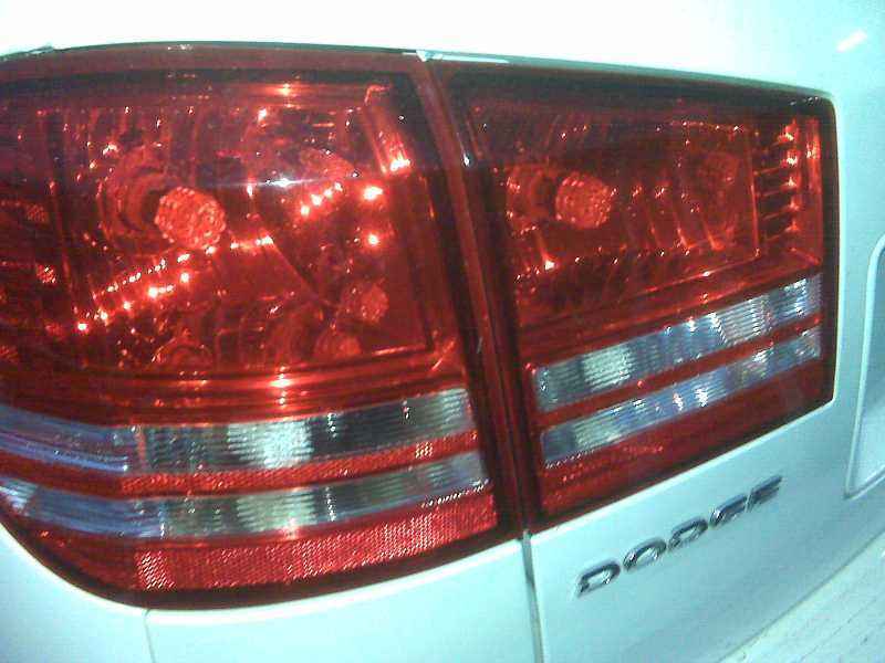

email4walker Posted October 21, 2009 Author Report Share Posted October 21, 2009 **Update** I am going to change my rear turn signal lights from 20 LEDs per bulb to 36 LEDs per bulb. I just want to see how that would look. I'll keep you all posted.... Quote Link to comment Share on other sites More sharing options...
Burn Posted October 22, 2009 Report Share Posted October 22, 2009 **Update**I am going to change my rear turn signal lights from 20 LEDs per bulb to 36 LEDs per bulb. No real reason why, I just want to see how that would look. I'll keep you all posted.... this only my opinion , but this is not what i call ''retrofitting'' ... this only replacing a bulb by another type of bulb (LED) .. a simple swap. I did this on my Dodge SX R/T and not long after i decided to revert back with the original bulb. This replacement LED Bulbs are poorly made , fragile and don't make enough light output during the day in direct sunlight... too much dangerous ... you step on the brakes and the driver behind you don't even see it .... Real led lights are two times bigger ... just look at your journey third brake light .. this is real leds that you can see in daytime what i call retrofitting is taking a big truck LED light assembly and make it fit into the taillight housing ... and by all means a mirrored led assembly like this one for the best light ouput : http://www.superbrightleds.com/store/html/images/pt_both.jpg Quote Link to comment Share on other sites More sharing options...
email4walker Posted October 22, 2009 Author Report Share Posted October 22, 2009 this only my opinion , but this is not what i call ''retrofitting'' ... this only replacing a bulb by another type of bulb (LED) .. a simple swap. I did this on my Dodge SX R/T and not long after i decided to revert back with the original bulb. This replacement LED Bulbs are poorly made , fragile and don't make enough light output during the day in direct sunlight... too much dangerous ... you step on the brakes and the driver behind you don't even see it .... Real led lights are two times bigger ... just look at your journey third brake light .. this is real leds that you can see in daytime what i call retrofitting is taking a big truck LED light assembly and make it fit into the taillight housing ... and by all means a mirrored led assembly like this one for the best light ouput : http://www.superbrightleds.com/store/html/images/pt_both.jpg The fourm was named "LED retrofitting" because another user started a thread about a year ago and it only talked about changing the lights/bulbs on the inside of the car. A lot of people already know about that thread and this was a "part two" of that beacuse this only talks about changing the outside lights. I could have used a better name, but I just stayed with what everybody already knows. As far using LEDs in general, that is what this thread is for. It is a "how to" for using LEDs. Did you read the WHOLE thread? Someone already voiced your concern and it was explained what you should do to get around that problem. With the wrong LED setup, your exatly right, it is very dangerous and they cannot be seen. Read the whole thread and it will tell you how to fix that problem, at least on your Journey it will. Quote Link to comment Share on other sites More sharing options...
email4walker Posted October 24, 2009 Author Report Share Posted October 24, 2009 I switched out my 20 LED rear turn signal bulb for a 36 LED bulb that looked like my brake light. The 20 LED bulb was better than the 36 LED bulb. The light was more intense and eye catching with 20 LED bulb. So, the type of LEDs matter. Also, just like I thought, the Amber 36 LED bulb color was not as good as the 20 LED bulb. Well everyone, my experiment is officially over. If you want to switch you bulbs to LEDs, you have a complete "how to" , even down to what types of bulbs to buy. It was fun. Enjoy B) Quote Link to comment Share on other sites More sharing options...
