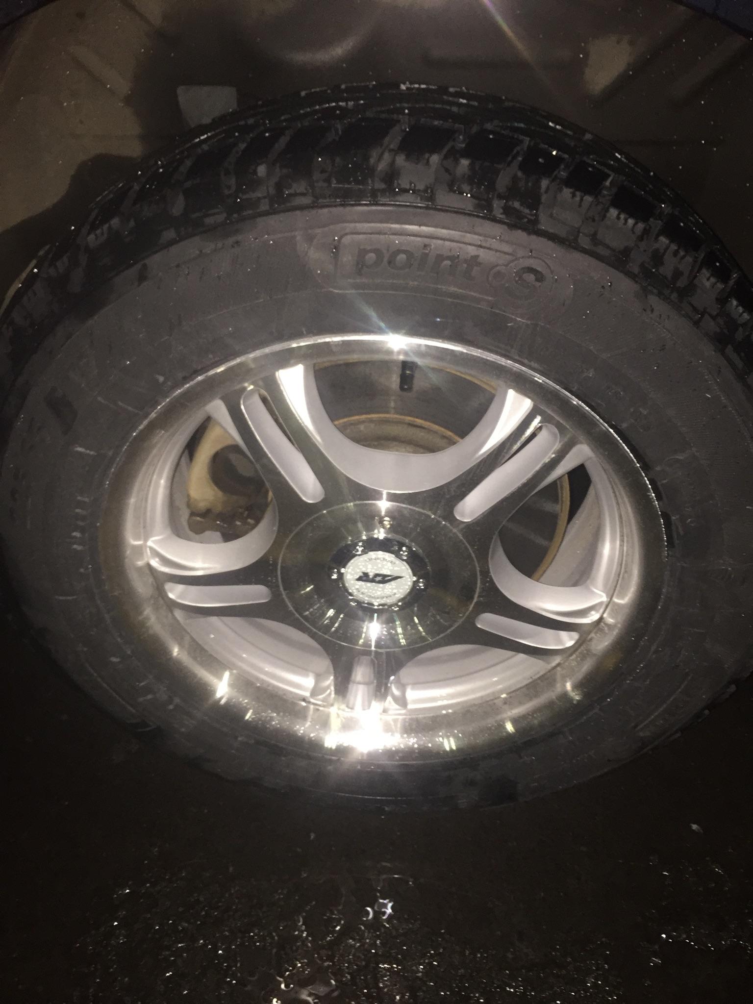

I've been reading the posts about folks swapping out their wheels with different sizes- Most people going to larger wheel diameter. I am trying to go the opposite way, from the factory Crossroad 19" to a 17 wheel for studded snow tires. Specifically this is for a 2015 DJ Crossroad AWD V6. I thought all factory 17" wheels and larger would work, but they don't. All the fitment guides on the net say they will, and other members here saying they will... but alas; there is interference with the caliper when trying 17" factory steel wheels from a 2013 DJ. Even tried 18" Jeep wheels that had 44mm offset and still nogo!
I have bit the bullet and outsourced my problem to my local tire monger. He has in turn contacted his suppliers with this dilemma. One of them replied with a custom wheel that they claim will fit (specially noted in their records) to the Dodge Journey Crossroad with the larger caliper (post 2012). I placed the order and are due in today or tomorrow. My gut is telling me they wont fit! We shall see...
The wheel is an American Racing Estrella. I don't have any other custom dimensional information yet.
So, my question is- who is running a wheel smaller than 19" on their 2013 or newer DJ Crossroad with the larger caliper? Please post what you've got and pics!
Well all is good here! Great fit and they look great! Lots of room for the Caliper! Sorry about the nighttime picture.
These are Point-S studded snow tires. I believe these are made by Continental and branded for Point-S (formerly Tire Factory). They just came out and have the latest composition technology etc. and the reviews have been excellent. Having owned Nokians, I have become a believer in them but they were out of stock in this size.
