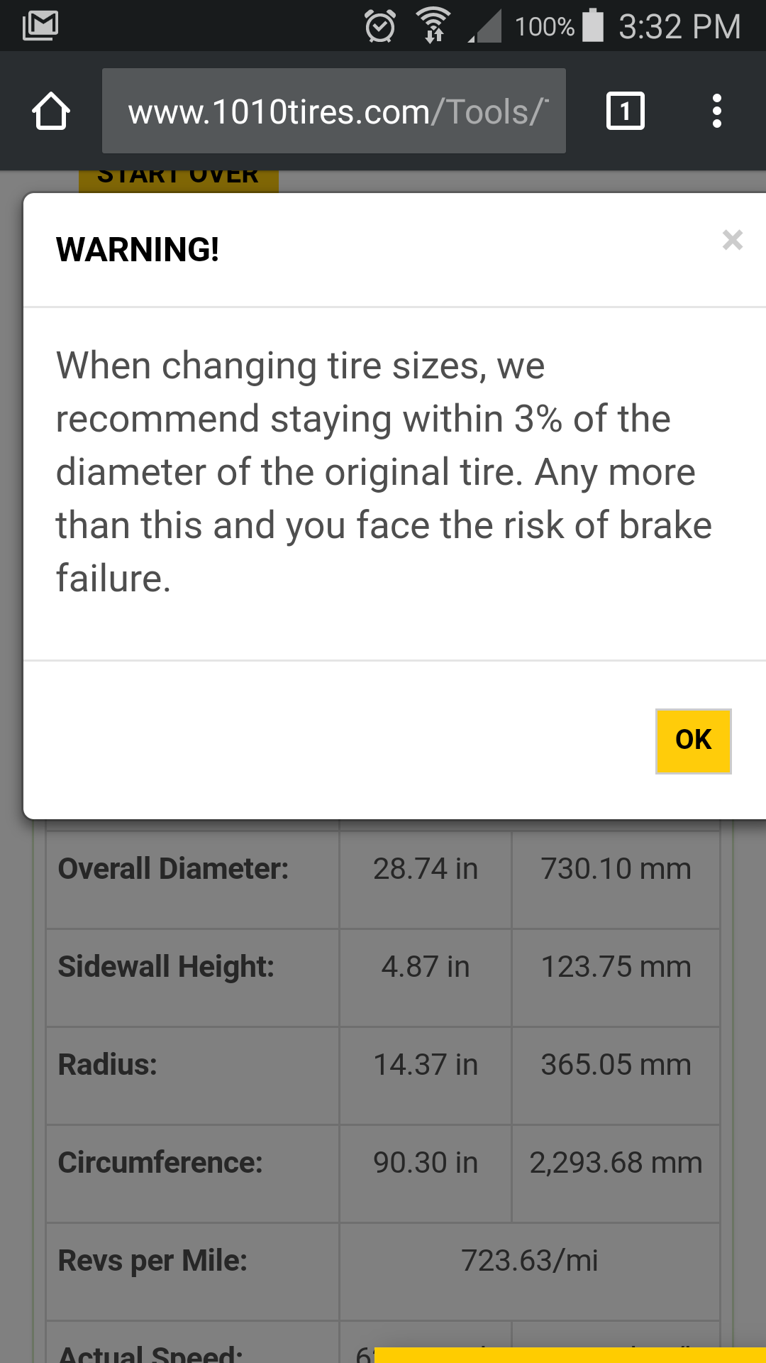

Trent Hager Posted February 4, 2017 Report Share Posted February 4, 2017 Hi , I currently have 235 55 19 on my 2011 dodge journey, I still have the 225 55 19 tires . I had a flat on one of the rear tires that's not repairable could I run one of the old tire on there , I checked a tire calculator and it's a difference of 1.51% . Quote Link to comment Share on other sites More sharing options...
2late4u Posted February 4, 2017 Report Share Posted February 4, 2017 should be okay as long as you dont have awd and just fwd Quote Link to comment Share on other sites More sharing options...
Trent Hager Posted February 4, 2017 Author Report Share Posted February 4, 2017 I have awd , but from what I've read as long as you are within 3% between sizes you should be ok Quote Link to comment Share on other sites More sharing options...
Trent Hager Posted February 4, 2017 Author Report Share Posted February 4, 2017 Quote Link to comment Share on other sites More sharing options...
2late4u Posted February 4, 2017 Report Share Posted February 4, 2017 (edited) well go for it and report back what happens,well that is if you are changing ALL the tires but you are only changing one tire if i read your report right also one wheel will be turning at a different rate then your other tires. but hey let us know. Edited February 4, 2017 by 2late4u Quote Link to comment Share on other sites More sharing options...
Trent Hager Posted February 5, 2017 Author Report Share Posted February 5, 2017 My plan is to changer both rear tires not just one. Quote Link to comment Share on other sites More sharing options...
