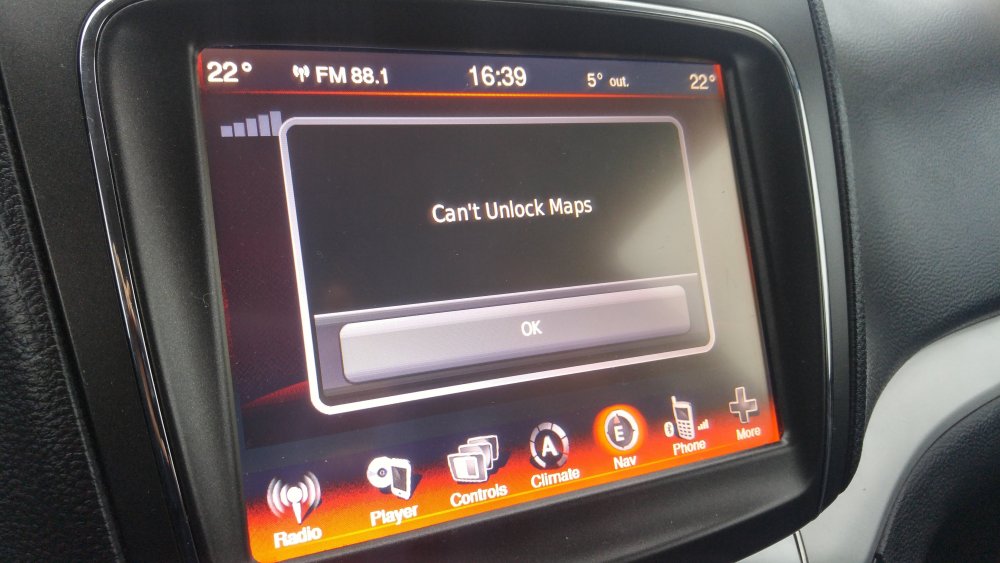

Miguel Pereira Posted January 21, 2018 Report Share Posted January 21, 2018 Hi everyone. Today upon starting the Navigation I got the "Can't Unlock Maps"... out of nothing like everybody else. My car is a 2014 with the 5 year/100,000 KM and currently sits at 55,400 km. My questions to all are: Should I proceed to a dealership to have it fixed/replaced under warranty? If i want to fix it with this topic, where can I download the files? Any PM would be helpful!... Quote Link to comment Share on other sites More sharing options...
Daniel Krajenke Posted January 25, 2018 Report Share Posted January 25, 2018 I have had the 2014 DJ and had units replaced to no avail. Can't unlock maps comes back. Leased a 2016 DJ and today can't unlock maps. This is a DJ issue and the only way it will go away is when they end production of the DJ. Thank god as this issue has been a pain in the butt for many people. Sad thing is this is going on years as an issue. There is no easy fix and as a consumer we should not have to jump through hoops downloading files from the internet in an attempt to fix this issue that will just keep coming back. I would never in my life ever purchase a DJ because of this issue and the dealers attitude towards the repairs on them. If you are thinking about buying a DJ don't walk away run. Terrible system and terrible PR on Chrysler's end. Quote Link to comment Share on other sites More sharing options...
