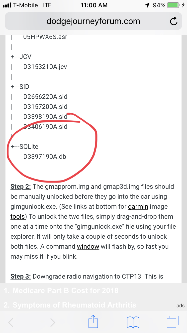

JAR414 Posted October 21, 2018 Report Share Posted October 21, 2018 On 10/21/2018 at 3:17 PM, bramfrank said: That directory shouldn't even be there. Look at the first post in this tread which will tell you what directories you need. The specifics of the file names depends on the map version you are installing. Expand I hate busting someone’s knuckles, but it’s right there in the first post. Doesn’t really matter much, since the DB file is a database of routes and POIs anyway, per Garmin. Their 2019.20 files do have the SQLite directory and DB file Quote Link to comment Share on other sites More sharing options...
bramfrank Posted October 21, 2018 Report Share Posted October 21, 2018 Well, the SQL directory isn't required. The POIs are integrated within the img file. And it is interesting . . . I hadn't actually checked that first post, I just assumed that the OP wouldn't list files that weren't required - the SQL file isn't listed in the site I used for my reference and it doesn't actually DO anything for you and isn't required; everything works perfectly without it. Reading through that opening post I was struck at how vehement the OP was in terms of his justifying a serious DMCA copyright violation on the basis of Chrysler's integrating the radio to the system, preventing the use of an aftermarket device . . . . something almost every car manufacturer does today. cody168 1 Quote Link to comment Share on other sites More sharing options...
JAR414 Posted October 21, 2018 Report Share Posted October 21, 2018 Not a big deal I seriously toyed with the idea of not doing anything about it Quote Link to comment Share on other sites More sharing options...

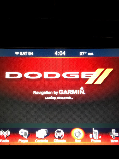

JAR414 Posted December 31, 2018 Report Share Posted December 31, 2018 I think I did something very wrong, trying to update to the Garmin 2019.30 maps. Went to downgrade from CTP17 to 13...followed the usual procedure, but had to interrupt the process after the flashing. Now the nav window has been showing "Loading, please wait" for quite a long time (since last night! See the picture) Any suggestions on what I can do? Quote Link to comment Share on other sites More sharing options...
Miguel Pereira Posted January 2, 2019 Report Share Posted January 2, 2019 I'm a the the same stage, for weeks now... After I lost the compass. I've tried over 10 different pens, DVD,s, using a battery booster, disconnect the battery for one hour, different firmware versions... After a visit to Dodge, they couldn't put it back to life either. I'm waiting for a new one. Quote Link to comment Share on other sites More sharing options...
