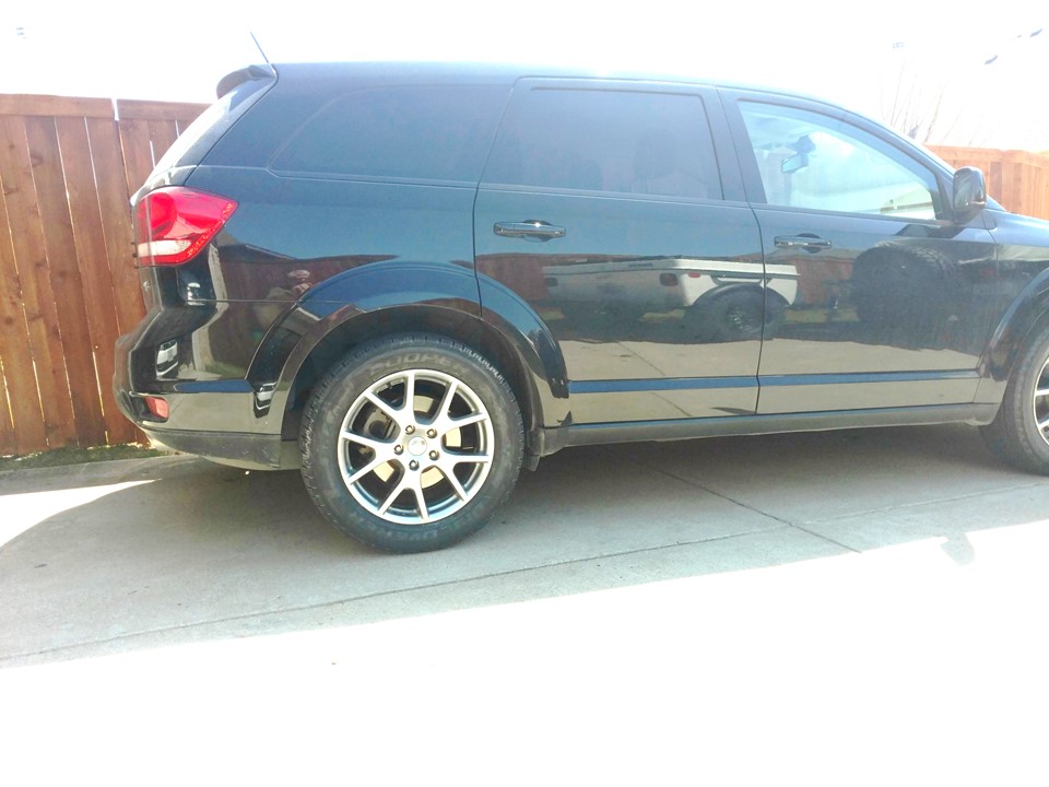

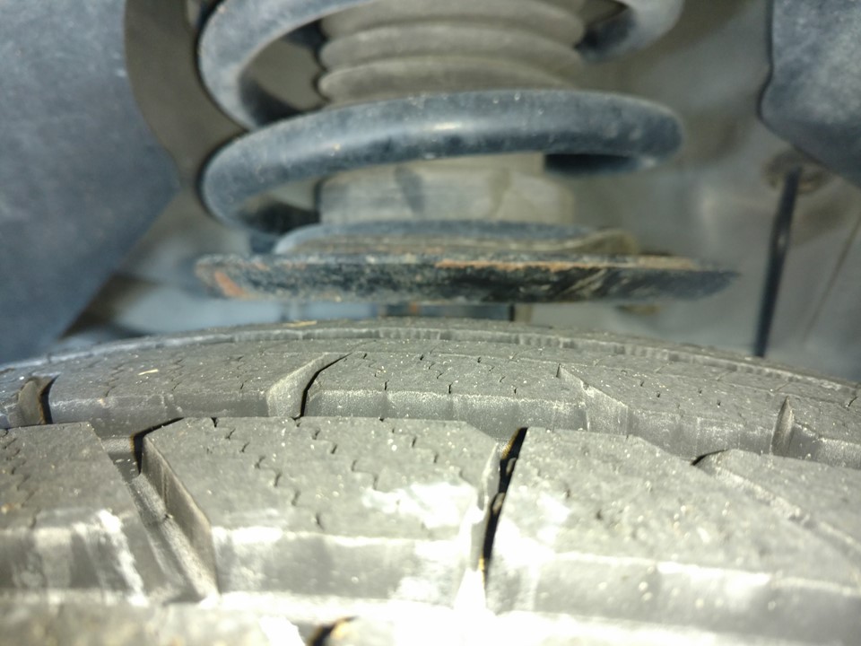

bluejeep Posted March 29, 2017 Report Share Posted March 29, 2017 2016 R/T AWD Installed cooper discoverer SRX in size 245 x 55 x 19. They justttttttt fit. Closest fit is on top of the front tire, where the tread is 3/16" below the spring support on the strut. See pic About .9" wider and 1.1" taller than stock 225 x 55 x 19 Kumho (which are dead after only 36k miles!) Quote Link to comment Share on other sites More sharing options...

nehvada Posted March 29, 2017 Report Share Posted March 29, 2017 (edited) with 245/55 the speedo is 3% off. why not use 255/50? this would be the nearly exact fit. Edited March 29, 2017 by nehvada jkeaton 1 Quote Link to comment Share on other sites More sharing options...
bluejeep Posted March 29, 2017 Author Report Share Posted March 29, 2017 I'm not at all concerned with the speedometer accuracy, sorry. Quote Link to comment Share on other sites More sharing options...

Steven Harshbarger Posted November 20, 2017 Report Share Posted November 20, 2017 (edited) I'm a big fan of cooper tires. I'm sure they'll serve you well. The def. fill up the tire well better than the stockers. I may have to look into them when I need my OE tires replaced. Have you noticed any ride difference or noise level while driving? Edited November 20, 2017 by Steven Harshbarger Quote Link to comment Share on other sites More sharing options...
bluejeep Posted November 20, 2017 Author Report Share Posted November 20, 2017 They feel very secure cornering, and are much more quiet than oem. Ride is nice Steven Harshbarger 1 Quote Link to comment Share on other sites More sharing options...
Steven Harshbarger Posted November 20, 2017 Report Share Posted November 20, 2017 I really dislike the OEM tires. I think they're loud. Awesome, thanks! Quote Link to comment Share on other sites More sharing options...
