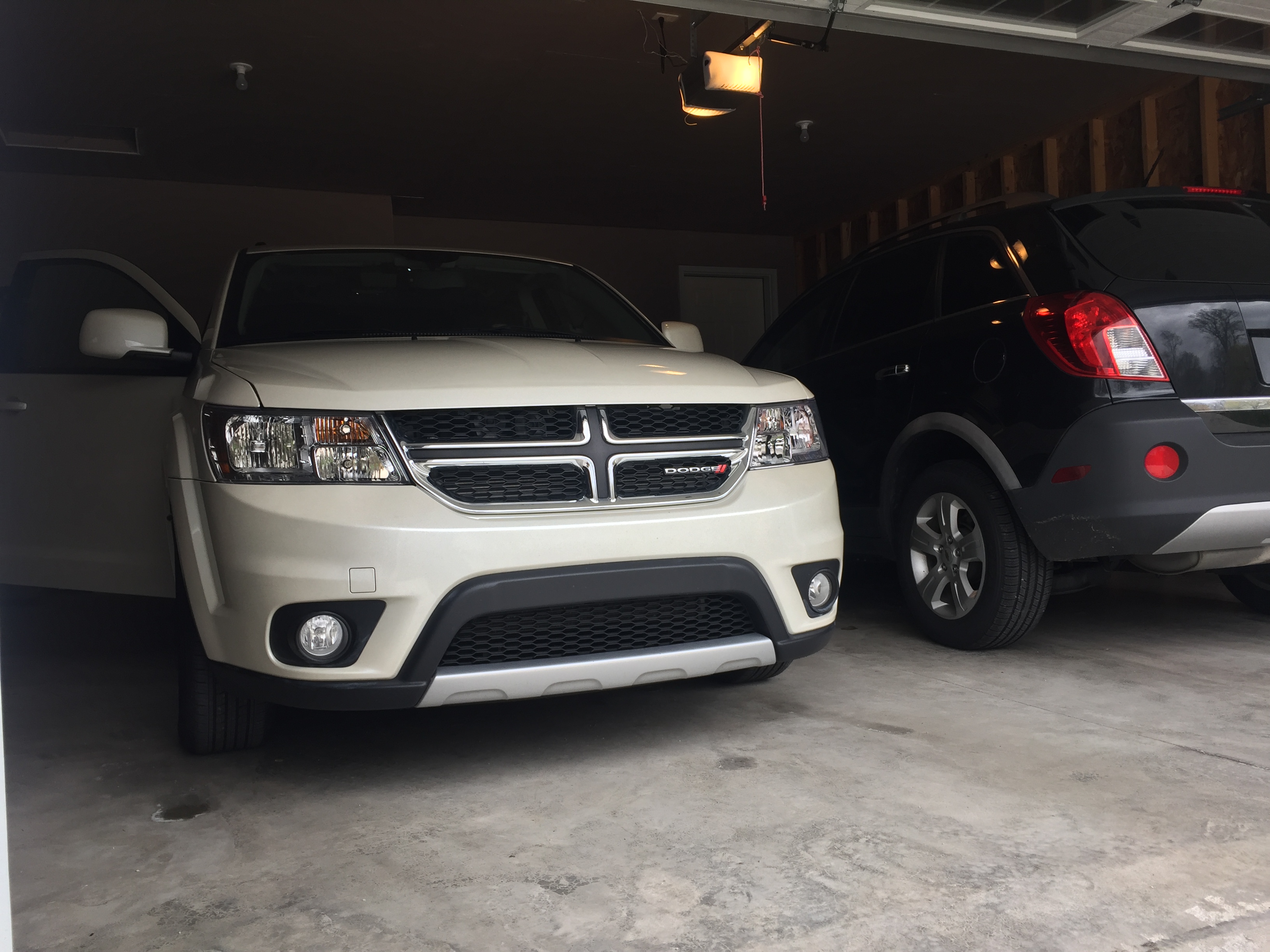

 I have been looking around the forums for a week or so as I recently purchased a 14  Dodge Journey!
