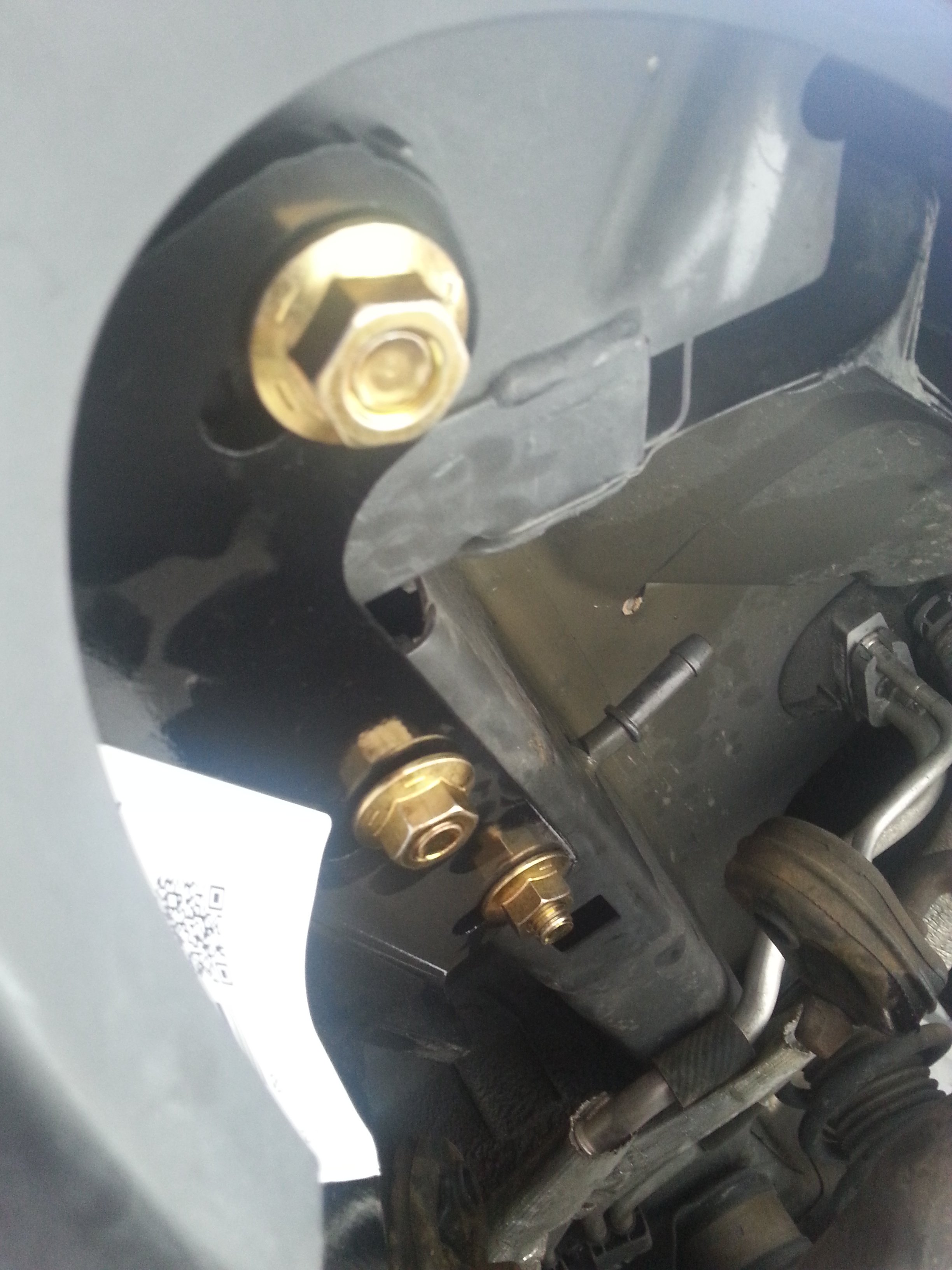

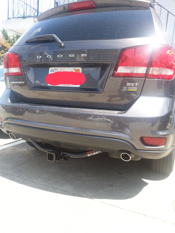

Armando G Posted June 9, 2017 Report Share Posted June 9, 2017 Finally received and installed my Curt hitch (13201) on my 2015 DJ. After reading all the posts on here and researching the options, it was easy to decide on the Curt package on eBay. I did want to originally use the pre-installed wiring on my Journey, but the hassle and cost from the dealer was ridiculous. Installation was pretty straight forward, with the hardest part being just getting started. Installation was done by myself (it is possible), no lifting, and with basic home mechanic tools. Maneuvering to the rubber exhaust hangers was actually the hardest part. Proud of getting it done and love how it looks. A big thank you to all the contributors on the forum. The information made my decision easier and have me the courage to do it myself. 2late4u, OhareFred and BrianS 3 Quote Link to comment Share on other sites More sharing options...

jkeaton Posted June 20, 2017 Report Share Posted June 20, 2017 Hope you used some thread locker on those nuts. Looks like a few are not engaging the bolt threads adequately. 2late4u 1 Quote Link to comment Share on other sites More sharing options...
2late4u Posted June 20, 2017 Report Share Posted June 20, 2017 (edited) 4 hours ago, jkeaton said: Hope you used some thread locker on those nuts. Looks like a few are not engaging the bolt threads adequately. just went and checked mine on mu 14 crossroad with curt hitch and mine are tightened tight, and the rear bolt does have more threads showing then what he has and also the 2nd from the rear also. maybe he took the picks before the final tight torque. i hope so anyway, lol. also i did go back about 2 weeks after install and checked my torque on the nuts okay for me..... Edited June 20, 2017 by 2late4u jkeaton 1 Quote Link to comment Share on other sites More sharing options...
Armando G Posted June 21, 2017 Author Report Share Posted June 21, 2017 14 hours ago, jkeaton said: Hope you used some thread locker on those nuts. Looks like a few are not engaging the bolt threads adequately. FYI...the pics are before tightening the bolts and torquing them. The exhaust was still hanging and I wanted to take pictures before I forgot. They were just hand tightened at the point of the pictures. Probably should of taken the picture after tightening ;-) jkeaton 1 Quote Link to comment Share on other sites More sharing options...
