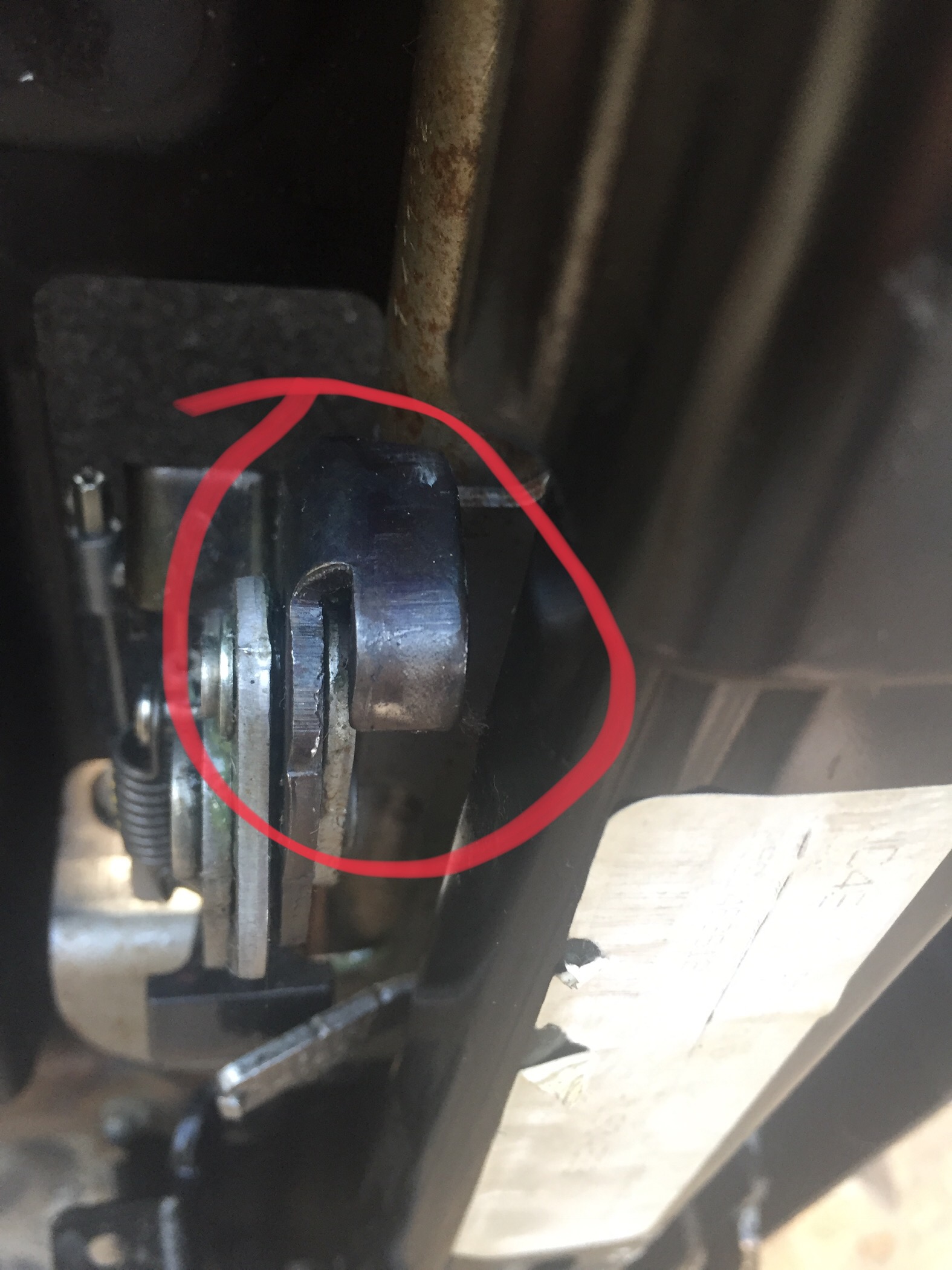

Dondago Posted November 20, 2019 Report Share Posted November 20, 2019 Hi. This happened to me 2 days ago. yesterday I fixed it. I will explain how I did it. first of all. The problem is the seat rail got stuck with one of the lever mechanisms. So this is what I did. 1 remove the second row seat. To do this you must remove 3 screws and a nut ( not hard) 2 take the seat out and place it on the ground facing up 3 in the upper part of the lower rail is the stuked mechanism. Loose it with the help od a screw driver or your hand. You can also give a fer knocks with a hammer to the rail. 4. Done. Now put all back together. I forgot to take pictures, but it wasn’t hard jkeaton and 2late4u 2 Quote Link to comment Share on other sites More sharing options...

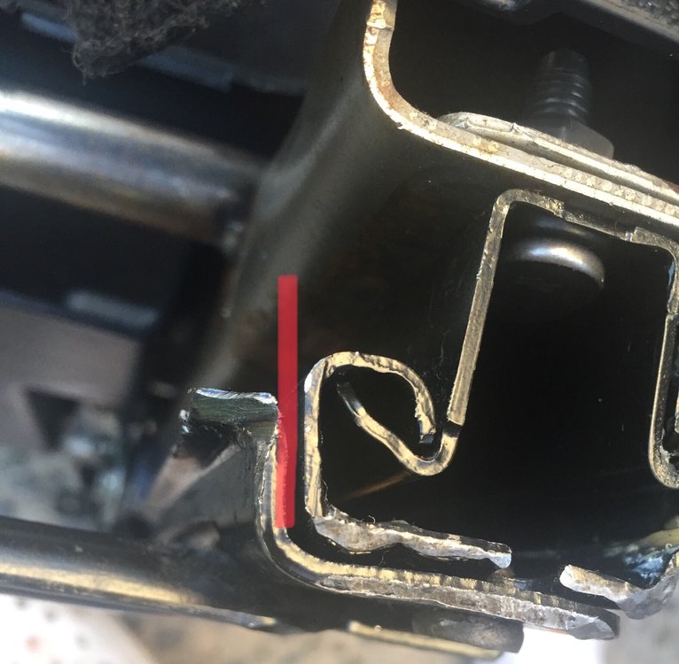

Dondago Posted November 25, 2019 Report Share Posted November 25, 2019 Hi again. After a couole of days the seat got stucked again. So now I took a picture of the mechanism. the problem now is that que security stop worn out. That means I had to make a new one. This time I place a piece of aluminium in the rail. as shown in the picture ( draw a red line) Armando G, jkeaton and 2late4u 3 Quote Link to comment Share on other sites More sharing options...
