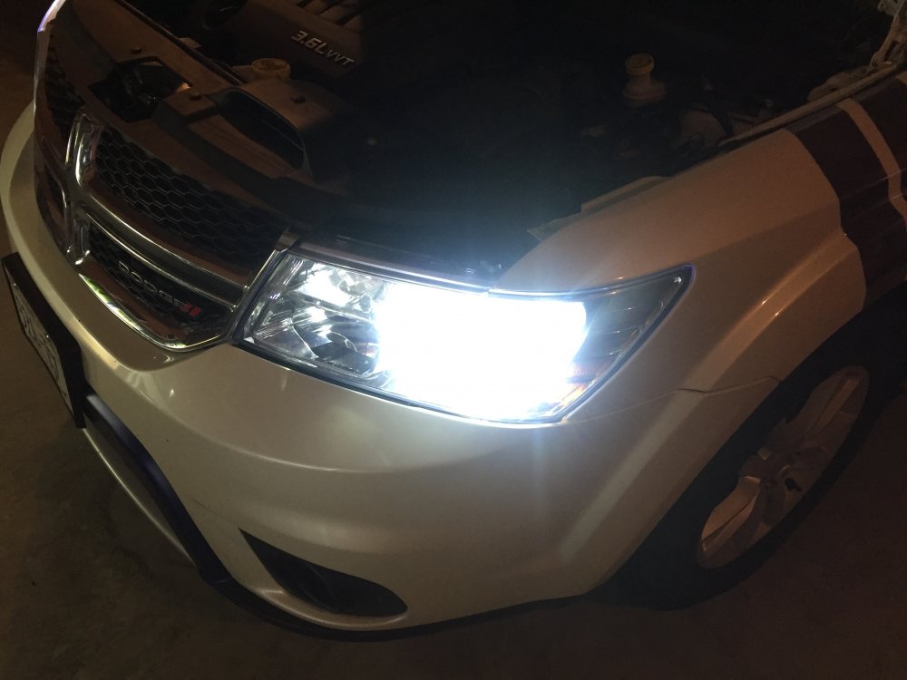

Baumrb Posted June 27, 2017 Author Report Share Posted June 27, 2017 Thanks everyone! Got my LEDs today and all seems to be good for the lows! ltdjourney, Fishkisser and jkeaton 2 1 Quote Link to comment Share on other sites More sharing options...
ltdjourney Posted June 27, 2017 Report Share Posted June 27, 2017 On 6/26/2017 at 5:23 PM, ltdjourney said: I checked my 2017 journey today and mt lights don't go out when I signal. Have third light which is orange and it flashes only??? did they change on 17's ???? What brand or name did you use please thanks 21 hours ago, Baumrb said: Thanks everyone! Got my LEDs today and all seems to be good for the lows! Wrangler015 1 Quote Link to comment Share on other sites More sharing options...
Baumrb Posted June 28, 2017 Author Report Share Posted June 28, 2017 Thanks everyone! I got Stark brand... they were a pretty cheap one off of eBay. Like $30 only but I like them! Quote Link to comment Share on other sites More sharing options...
jkeaton Posted June 28, 2017 Report Share Posted June 28, 2017 Got mine off amazon. Probably $70 for low/high and fog light bulbs. Quote Link to comment Share on other sites More sharing options...
