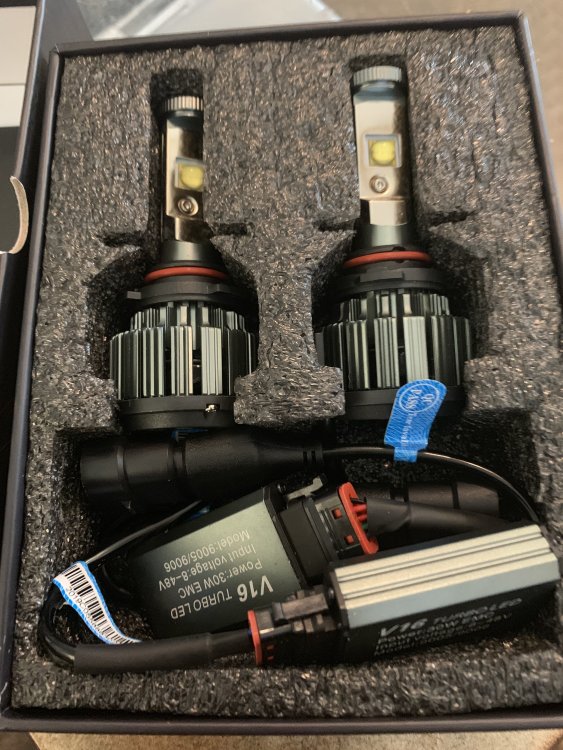

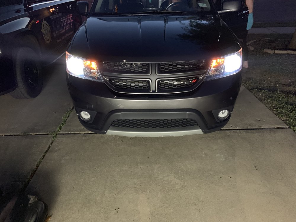

martyman.geo Posted April 1, 2019 Report Share Posted April 1, 2019 JKeateon, Thank you for explaining that. I ordered a low beam set with the CANbus attached on the 14, they came in on the 28 and installed them this afternoon. Don't look into the light after they are in. Pretty darn bright in the daylight. I want to check them out at night to see the difference. I did make sure the flat sides facing the sides not up and down. jkeaton and Bdberry 2 Quote Link to comment Share on other sites More sharing options...
