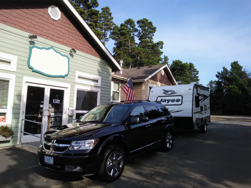

William Burke Posted December 18, 2019 Report Share Posted December 18, 2019 We use our 2010 DJ R/T 3.5L engine to tow our small 14' travel trailer (2290 lbs.) We put most of our cargo in the car. We had U Haul install a hitch with brake controller. We added a weight distribution hitch and has been the key to safe handling. Just don't push it up steep grades! P.S. Our DJ came with a trans cooler, so I'm sure that helps too. Summer Solstice 1 Quote Link to comment Share on other sites More sharing options...

Summer Solstice Posted February 4, 2020 Report Share Posted February 4, 2020 On 12/18/2019 at 6:25 PM, William Burke said: We use our 2010 DJ R/T 3.5L engine to tow our small 14' travel trailer (2290 lbs.) We put most of our cargo in the car. We had U Haul install a hitch with brake controller. We added a weight distribution hitch and has been the key to safe handling. Just don't push it up steep grades! P.S. Our DJ came with a trans cooler, so I'm sure that helps too. That is a nice looking set-up. William Burke 1 Quote Link to comment Share on other sites More sharing options...

William Burke Posted February 4, 2020 Report Share Posted February 4, 2020 15 hours ago, Summer Solstice said: That is a nice looking set-up. Thank you! It is a lot of fun! Summer Solstice 1 Quote Link to comment Share on other sites More sharing options...
