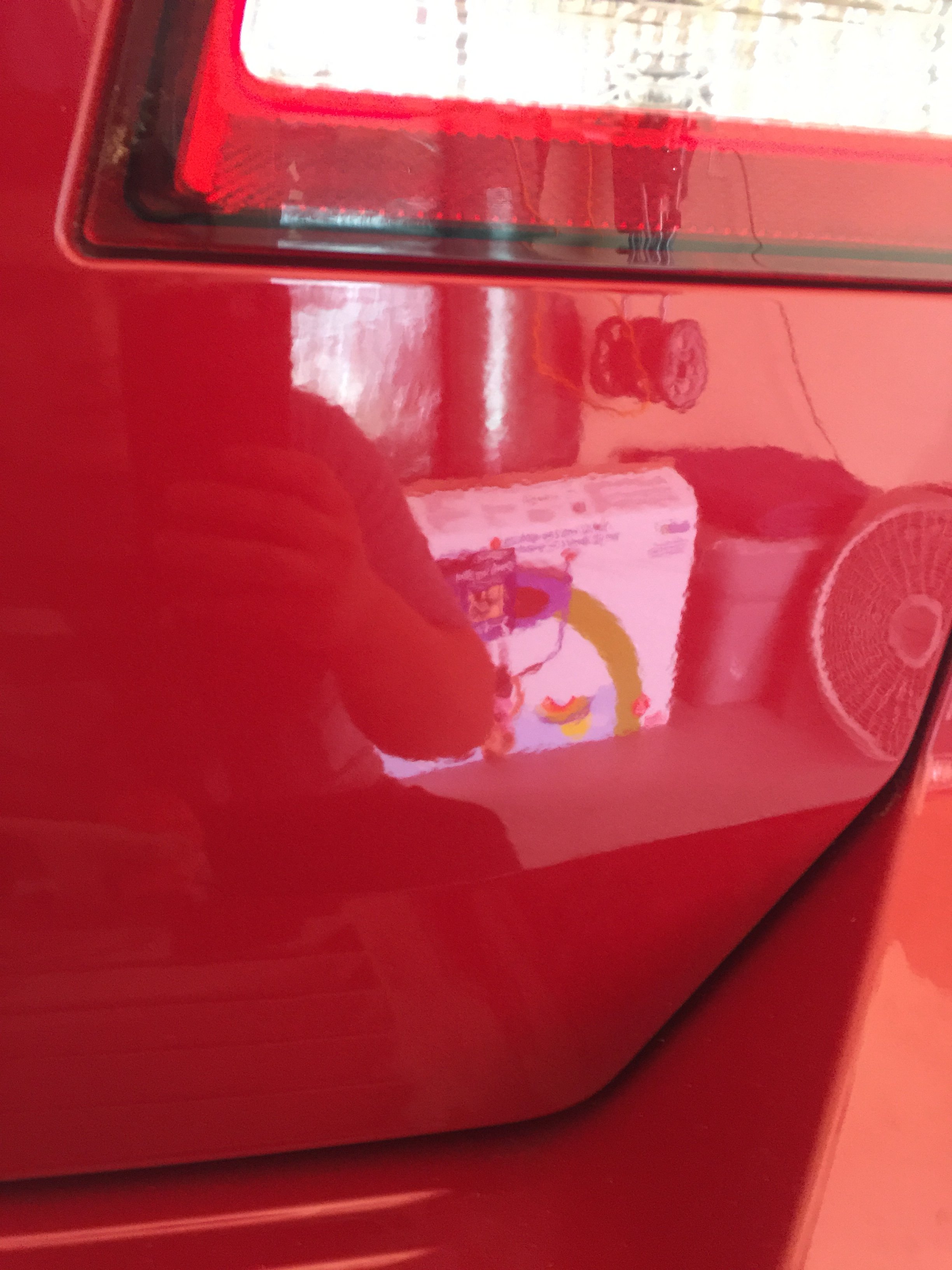

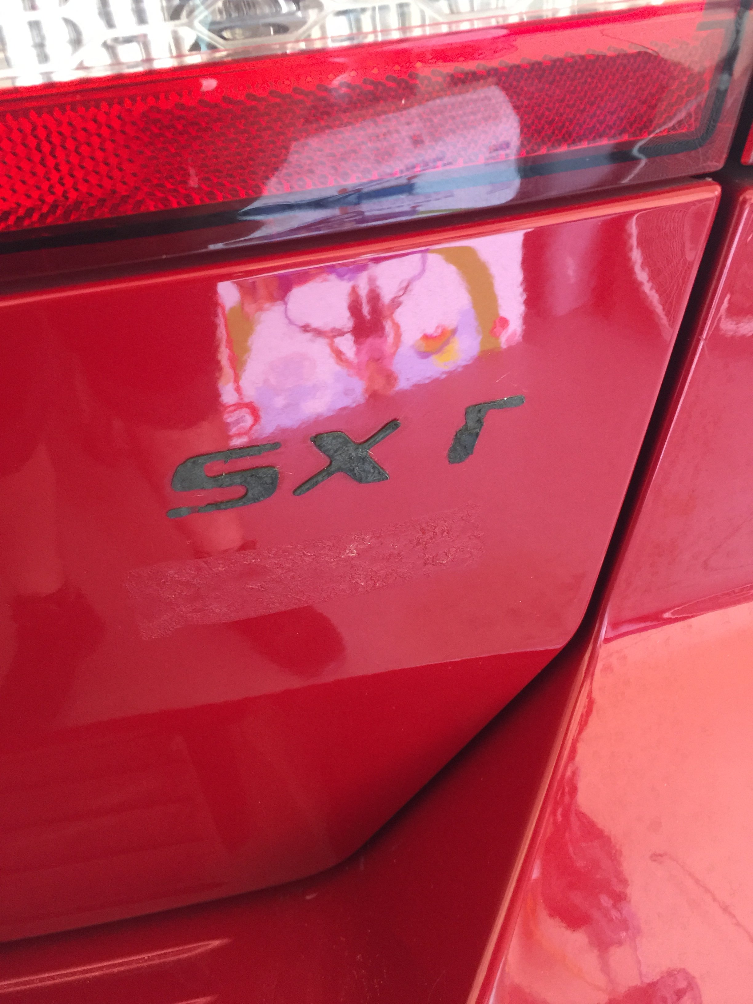

Eduardo831 Posted August 19, 2017 Report Share Posted August 19, 2017 (edited) So I decided to delete some of the emblems for a cleaner look in my opinion your entitled to yours. Anyways you'll need fishing wire I used a 12lb-tug nothing fancy and a decal eraser purchased from Amazon for 11 dollars and a hairdryer( is what I had on hand) or heat gun and finally a power drill. 1. Heat the emblem you want to delete use fishing wire to get behind it and pull through 2. Use the rubber decal eraser pad on a power drill and be amazed of how easily it removes it. It took me about 2 mins to remove the residue from the emblems. Pictures speak for themselves good luck no polishing was done after I used the eraser I didn't see a need. Edited August 19, 2017 by Eduardo831 Typo Quote Link to comment Share on other sites More sharing options...
2late4u Posted August 19, 2017 Report Share Posted August 19, 2017 you made it sound hard and expensive to remove the emblems... i used bumper sticker remover from autozone and just sprayed it on and let it set a minute then used my fingernail to lift the edge of the emblem and then sprayed a little more of the spray and slowly removed the emblem then wiped it clean ..done ...easy peasy no heat gun no fishing wire no decal eraser or power drill jkeaton, Bryman31 and Armando G 1 1 1 Quote Link to comment Share on other sites More sharing options...
Eduardo831 Posted August 19, 2017 Author Report Share Posted August 19, 2017 Just now, 2late4u said: you made it sound hard and expensive to remove the emblems... i used bumper sticker remover from autozone and just sprayed it on and let it set a minute then used my fingernail to lift the edge of the emblem and then sprayed a little more of the spray and slowly removed the emblem then wiped it clean ..done ...easy peasy no heat gun no fishing wire no decal eraser or power drill I should of made a video my method took mins what your describing I have experience doing that on my g35 was not fun and took for ever. That is why made this post to let others know the easiest most effective method. For example if you have side moldings you would not want to use your finger nails or bumper sticker remover that would take forever. Quote Link to comment Share on other sites More sharing options...
2late4u Posted August 20, 2017 Report Share Posted August 20, 2017 3 hours ago, Eduardo831 said: I should of made a video my method took mins what your describing I have experience doing that on my g35 was not fun and took for ever. That is why made this post to let others know the easiest most effective method. For example if you have side moldings you would not want to use your finger nails or bumper sticker remover that would take forever. didnt take me forever, but whatever.... less than 10 minutes for all the emblems that i wanted off... Eduardo831 and jkeaton 2 Quote Link to comment Share on other sites More sharing options...
