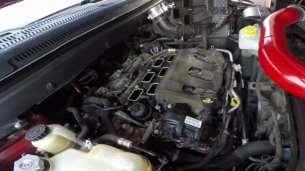

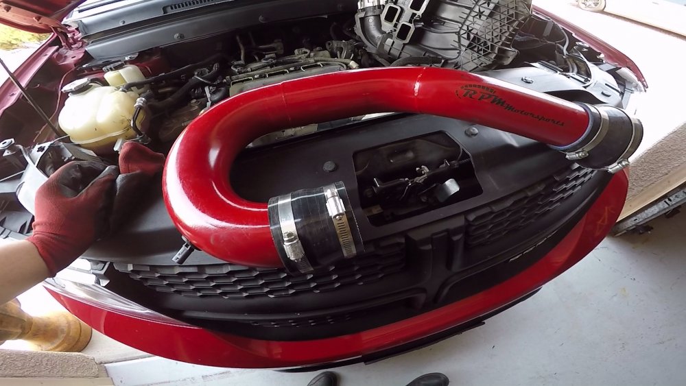

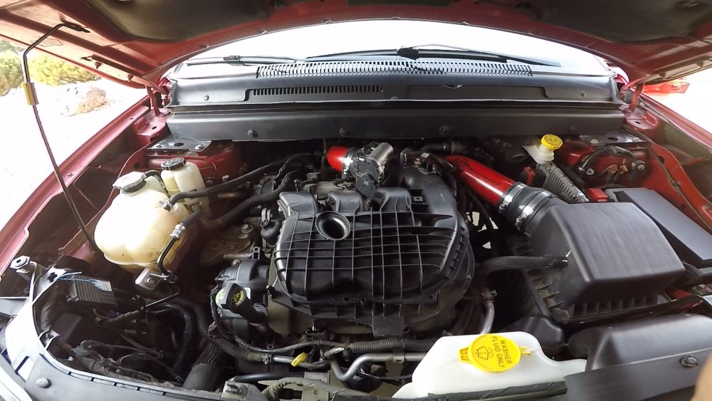

Eduardo831 Posted August 31, 2017 Report Share Posted August 31, 2017 On 8/27/2017 at 8:39 PM, Bryman31 said: so in my new search ive found ZERO air intakes for the journey's? this kinda sucks really. unless im missing something someone else knows?? really several aftermarket headlight housings but ZERO cold air intakes? There are intakes that will delete both restrictive resonators on the Journey. RPM-Motorsports in Arizona provides them. I purchased one in my opinion it wasn't worth the price I bought it for 200 dollars I did notice the throttle response was on point other than that more noise and mpg was the same. If they were to change its price to 80-100 dollars then I would think it's worth it. Installation wasn't bad but top plenum must be removed for RPM motorsports resonator intake delete to be installed properly. jkeaton 1 Quote Link to comment Share on other sites More sharing options...
Bryman31 Posted September 1, 2017 Author Report Share Posted September 1, 2017 (edited) 12 hours ago, Eduardo831 said: There are intakes that will delete both restrictive resonators on the Journey. RPM-Motorsports in Arizona provides them. I purchased one in my opinion it wasn't worth the price I bought it for 200 dollars I did notice the throttle response was on point other than that more noise and mpg was the same. If they were to change its price to 80-100 dollars then I would think it's worth it. Installation wasn't bad but top plenum must be removed for RPM motorsports resonator intake delete to be installed properly. thanks for that info. do you happen to have a pic of it installed? also whats the "top plenum"? Edited September 1, 2017 by Bryman31 Quote Link to comment Share on other sites More sharing options...
Johnnyh Posted September 3, 2017 Report Share Posted September 3, 2017 The K&N is for the Journey is $59.00 and lasts a lifetime. I put one in almost every car I owned. It improves MPG slightly breathes better for longer and the cleaning once a year or two depending on conditions is easy. I also use them on my Harleys. Bryman31 1 Quote Link to comment Share on other sites More sharing options...
Armando G Posted September 4, 2017 Report Share Posted September 4, 2017 On 8/28/2017 at 7:14 AM, jkeaton said: Not to me, but others will chime in swearing that they have picked up XXHP and XXMPG's just by installing a filter. To me, spending $10-15 every 2 years for a paper filter is better than spending twice that much for, say a K&N drop in filter that requires periodic cleaning and oiling. Which is a pain. Amen to jkeaton. Maybe an increase in a supped up street racer...not daily drivers. Quote Link to comment Share on other sites More sharing options...
Eduardo831 Posted September 4, 2017 Report Share Posted September 4, 2017 On 8/31/2017 at 9:16 PM, Bryman31 said: thanks for that info. do you happen to have a pic of it installed? also whats the "top plenum"? Sure Ill post a picture later today and TOP plenum is where the throttle body is mounted on the journey is made of some sort of plastic composite on other vehicles plenums are made of aluminum or steel just various. Bryman31 1 Quote Link to comment Share on other sites More sharing options...
Bryman31 Posted September 4, 2017 Author Report Share Posted September 4, 2017 3 hours ago, Eduardo831 said: Sure Ill post a picture later today and TOP plenum is where the throttle body is mounted on the journey is made of some sort of plastic composite on other vehicles plenums are made of aluminum or steel just various. ill keep an eye out for your pic. maybe point out which piece you had to take off. itll help an amateur like me out. did the instructions state having to remove it as well? Quote Link to comment Share on other sites More sharing options...
Eduardo831 Posted September 6, 2017 Report Share Posted September 6, 2017 Bryman31 and WytChoclitJ 2 Quote Link to comment Share on other sites More sharing options...
Eduardo831 Posted September 6, 2017 Report Share Posted September 6, 2017 So this intake resonator delete kit is by RPM-Motorsports I say its overpriced but still bought it $199 it has stock air box and drop in K&N filter btw. Is it louder cant say I have an aftermaret exhaust, but throttle body response is noticeable. Also Top Plenum has to be removed as seen in the pics since tube is one piece you risk scratching the tube or tearing a cable. WytChoclitJ 1 Quote Link to comment Share on other sites More sharing options...
